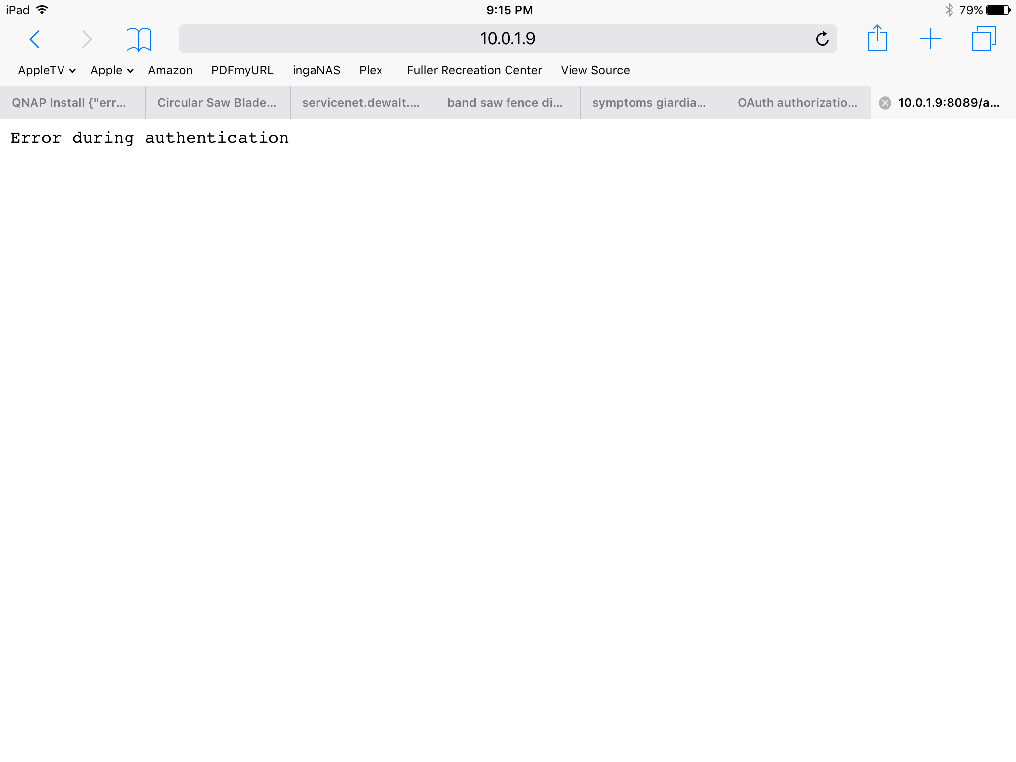

I’m getting an “Error during authentication” message with QNAP as well.
I was getting the above error but replaced domain the local IP and I got past that error. I tried both Chrome and Safari.

Sounds like a separate issue. Can you post a screenshot?

No, it doesn't work with the local IP. Mine is 10.0.1.9. I'll try the screenshot again.
Try to visit http://10.0.1.9:8089/auth/logout and then login again.
No dice. On safari on iPad I visited the link. Clicked log on and immediately got the same error.
Then I opened chrome on iPad. Did the same thing. This time when I clicked logon it brought up the logon page, I selected twitter and entered twitter credentials. It took my credentials and redirected me back to channels community but nothing else. Almost like it it forgot to go to the DVR application and tell it I authenticated. If I start over it immediately gives the above error.
