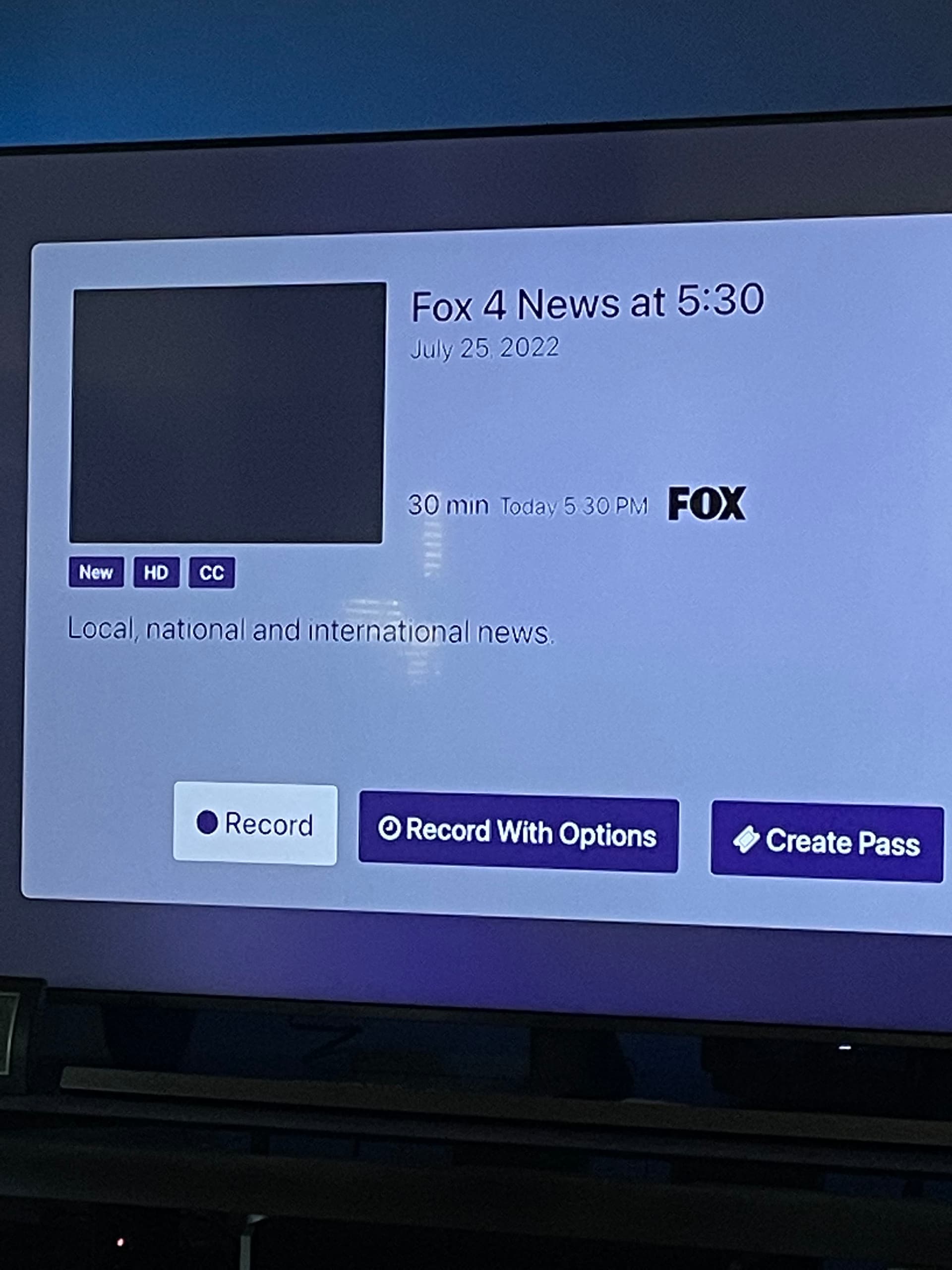

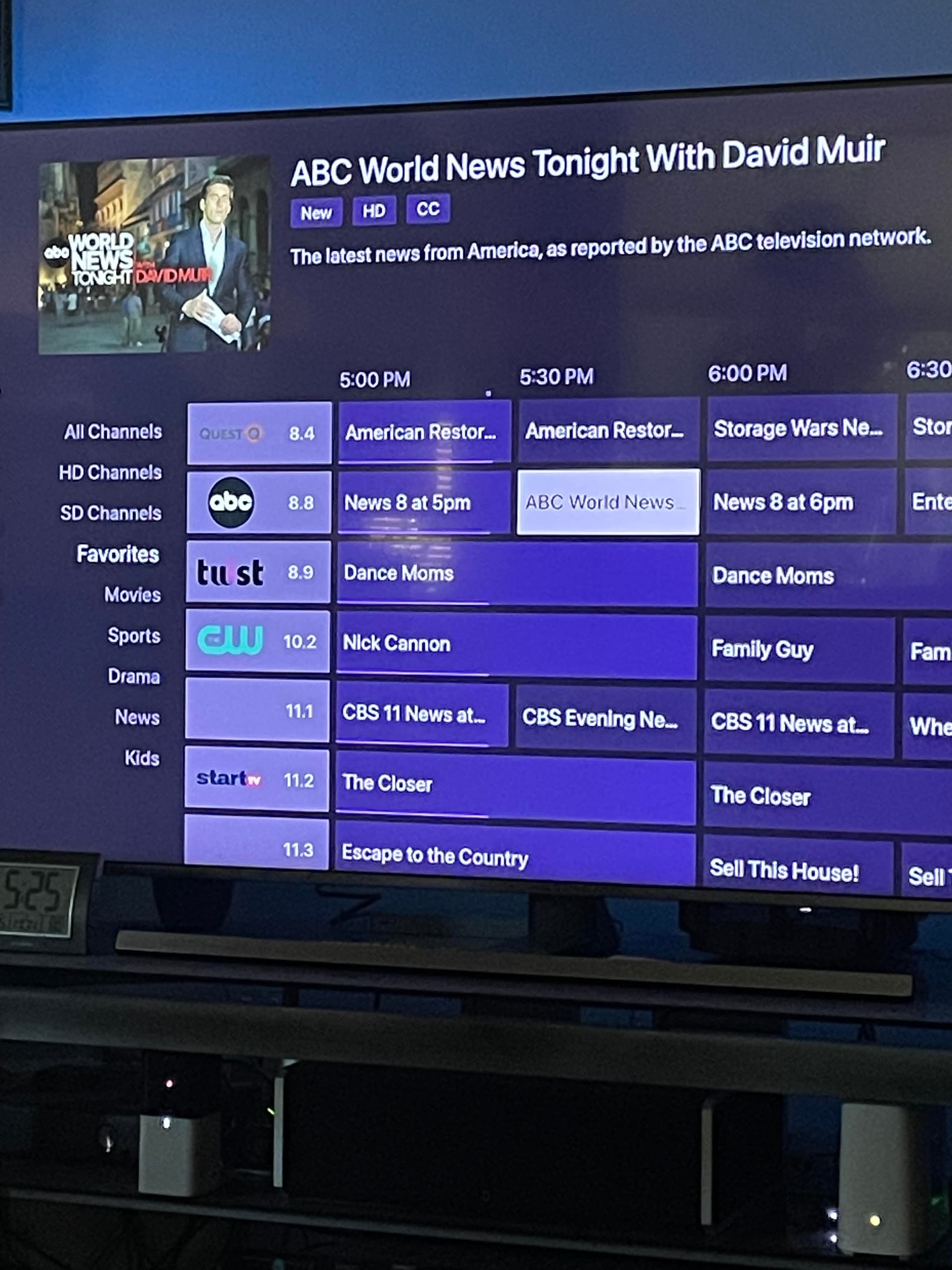

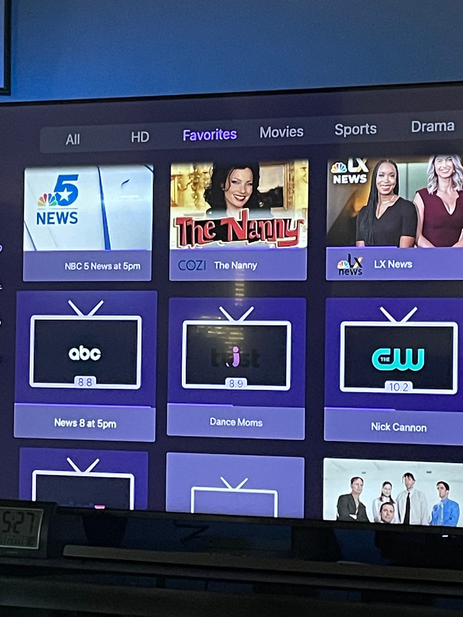

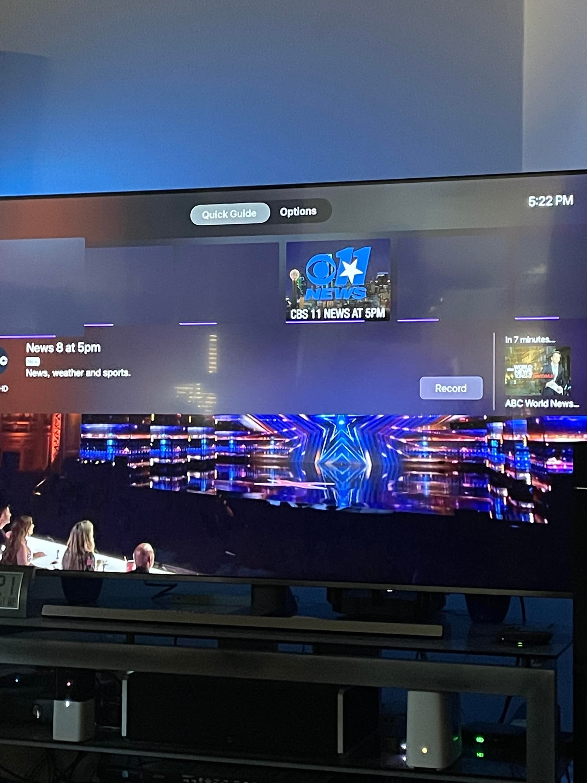

i just migrated to a qnap from a standalone linux vm and i have noticed that all the images in the Quick Guide are not fully populated. the are black but have the progress bar which is weird. so i will have some that display what is on and others that are just black with a progress bar but yet the text of what is on it there. this happens on beta and non beta version of the app. shat do you need from me to help with this issue.

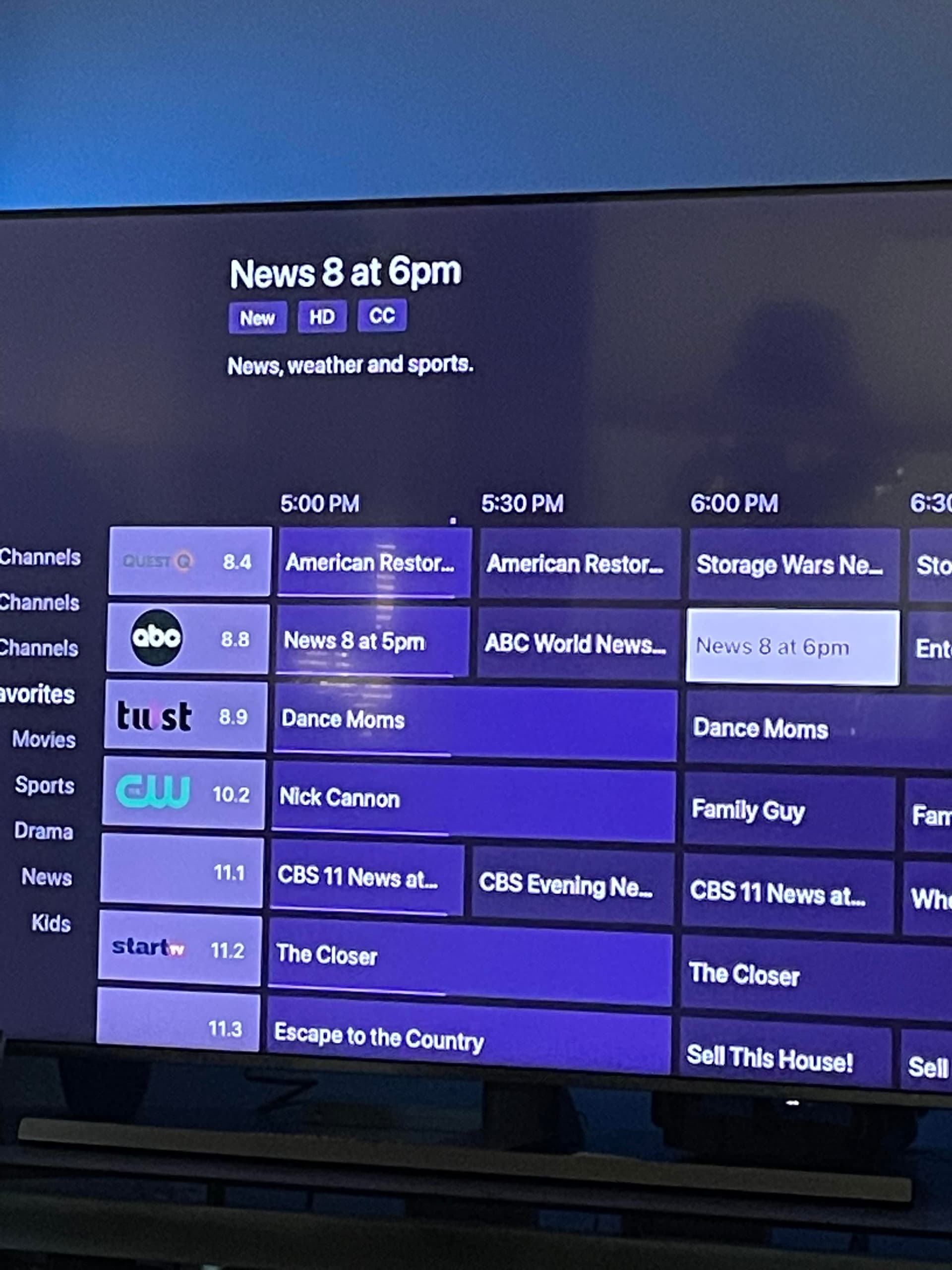

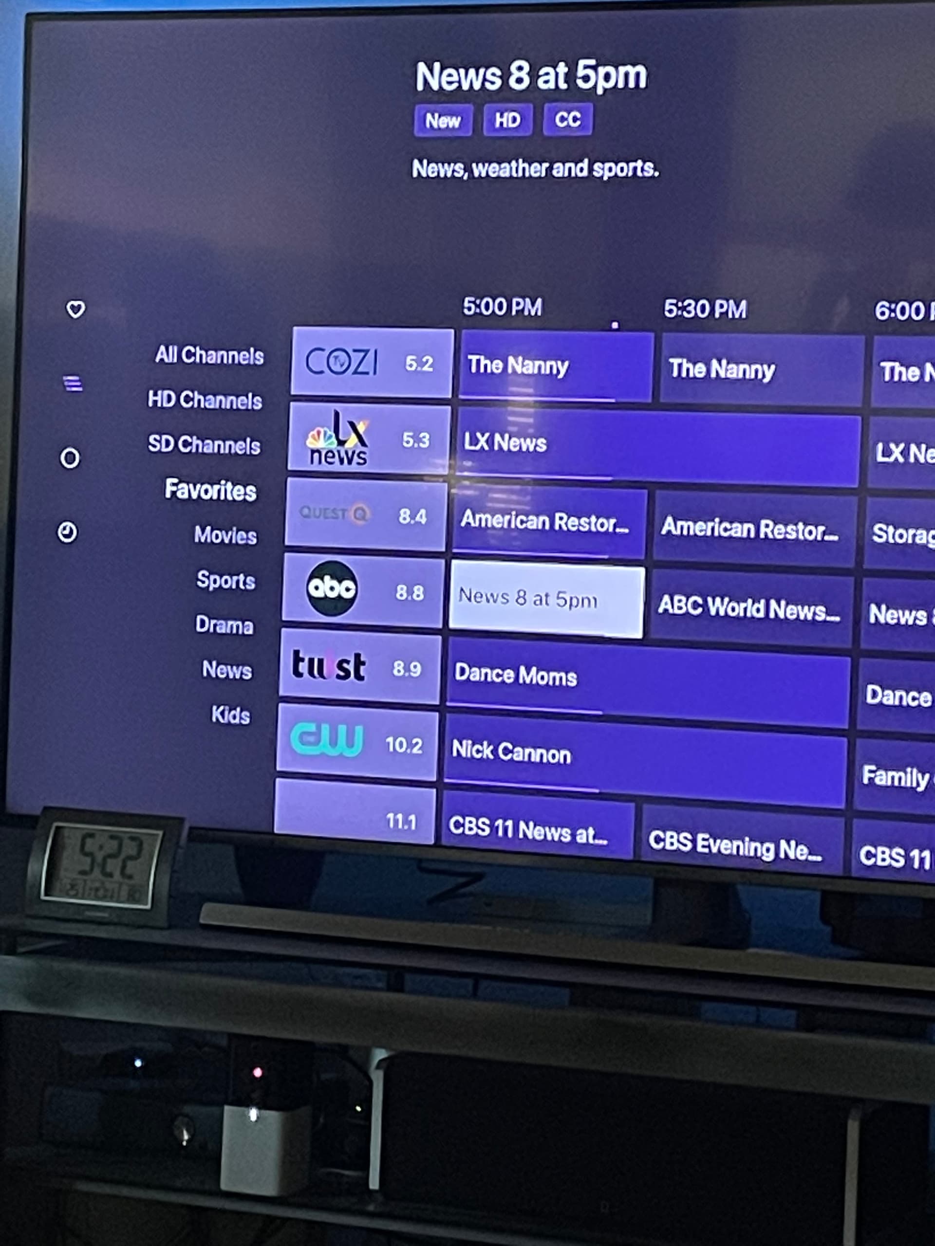

so a full refresh of the guide helped alot but have just a few now also restarted and update TVos (15.6) and still have just a few. on the on now screen those channels that are blank with a progress bar on the quick guide just display the channel logo. I also refreshed the channel logo just to see if that helped of course not.
Okay so they don't have guide data probably? Is there data on the grid in the app or on the dvr web UI?
yes there is data there
