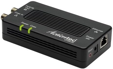

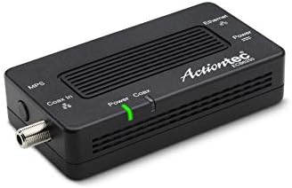

I'm looking at this equipment.
So. The modem and router being downstairs, I'll use the MoCa adapter to send the signal upstairs to the bedroom where it will hook to a satellite for a wired backhaul. The third satellite will go in the second bedroom and be wireless.

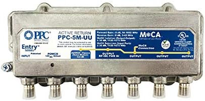

I've read I need MoCa filters:
5 PACK Filter, MoCA"POE" for Cable TV & OTA coaxial networks ONLY
I'm confused where to install those. I assume one at the main drop coming into the residence, and another on each of the adapters.
Things I'm considering. 2 MoCa adapters for a wired backhaul to both satellites. So it would be the modem and 2 MoCa adapters running off of one wall coax outlet. Too much on one outlet? A satellite in each bedroom connected through MoCa. Also, perhaps getting a better mesh system that has 4 ethernets on each unit, like a high end Orbi, or Asus ZenWifi
The idea is that if it has an Ethernet port, that's how it will be connected.
