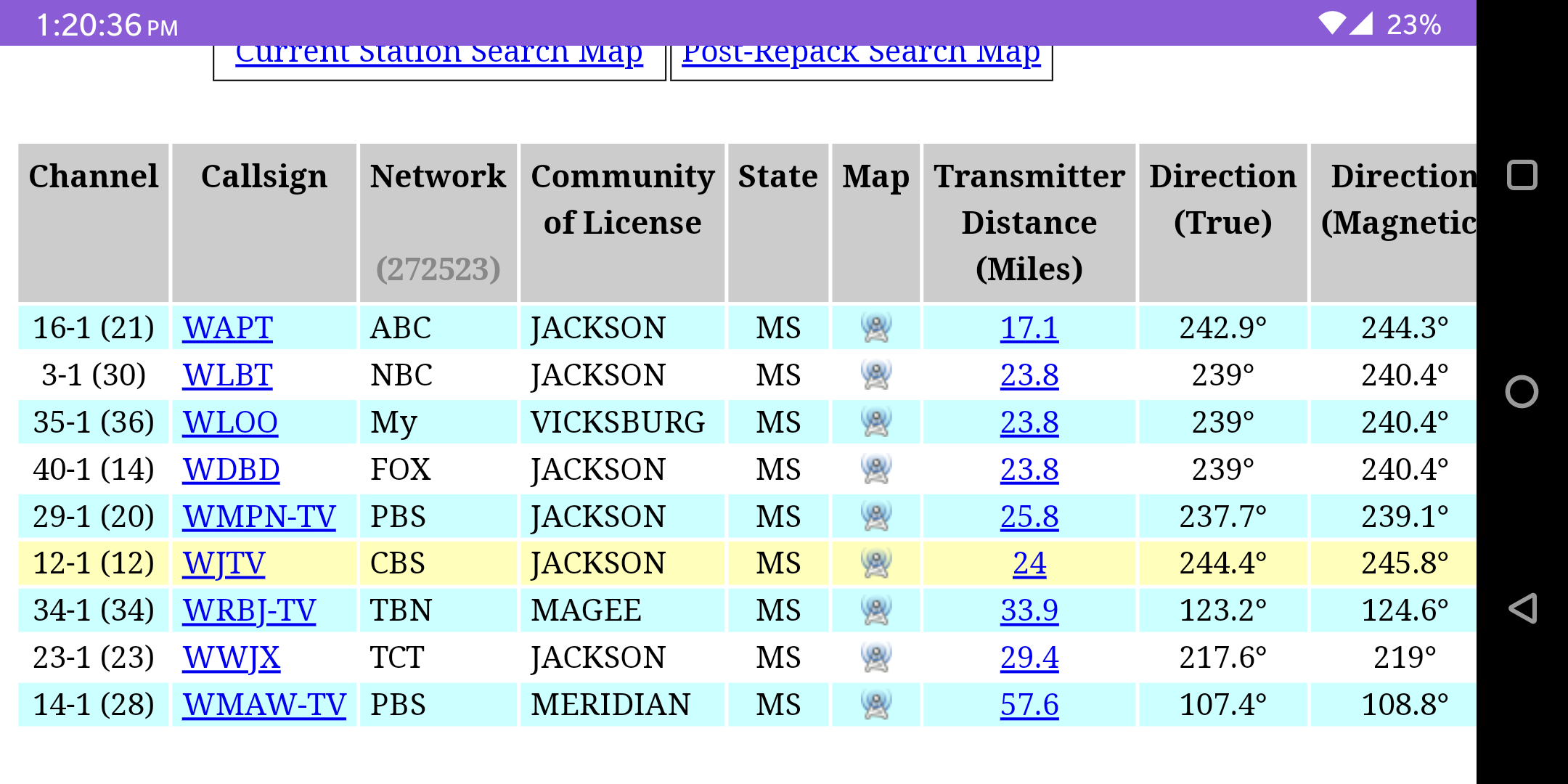

Start here:
- Post a rabbitears survey of where you are.
- How long is your cable run from antenna to HDHR? Without the answers to these 2, anyone giving an opinion on antenna/amp is outright guessing. You may not need anything, and may only need to repoint, as you suggest.
- As for mesh wifi vs MOCA - hold off on purchasing anything before you exhaust your moving things around options, like relocating the cable modem / main wifi router. You may save your self time and money, and end up with a better solution overall.
It's a 50ft coax routed out the back door, up the exterior wall back into the attic. About 15 ft are wrapped up in a service roll. It's pretty rigged up. I have definitely thought of relocating the hdhr to the attic with the antenna.
Heh - your screenshot cuts out the important stuff
If you still have the anonymized URL (further up the screen), better to post that
50-100ft (of good cable) is fine, but it dictates the need for a preamp. This one isn't as good as the older model, but it's cheap and good enough for me
Yeah - your signals are pretty strong - i wouldn't worry about your antenna at all, assuming you can get CBS (on 12 VHF) with it.
