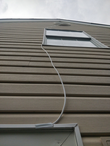

You may want to loop the cable so you don't get rainwater running down it into your living room.
Sorry that makes me cringe. Any way to wall fish that or possibly come down from the attic to a closet? I started my career as a cable installer so forgive my scrutiny. I know it works but....
Scrutiny forgiven, my last job was, check this out, a cable installer lmao. I've only worked in a few houses though, these were mainly schools. The main reason I haven't ran anything permanent is that it's a condo, so idk how much I can change, but we own the condo, so who's gonna complain. I've only found one possible way from the attic to the first floor. There is a closet on the 2nd floor with the air handler in it, and going through that floor will put me right by the entertainment center downstairs, but where, could be a couple feet off. I need a way to have someone stand directly above me on the 2nd floor and we somehow know if we are actually standing directly above / below each other before I go getting out the hammer drill. An app? Real equipment? Another reason I haven't done anything permanent yet, is I'm not sure what I'm going to do. I want the easiest possible solution. I had this idea that I was going to somehow get the coax downstairs from the attic, but I don't think that's necessary anymore. I can access the attic from the air handler closet on the 2nd floor, and it shares a wall with the bedroom. I'll go into the bedroom with it.
So. Antenna in the attic. Coax going down through the closet into the adjacent bedroom. Probably 20 ft will be plenty. I'll install a fancy wallplate. In place of the coax going up the outdoor wall will be a temporary network cable that I also route into the bedroom and hook up to a cheap switch. So I've moved the hdhr upstairs to make the coax run shorter, and indoors, and permanent most likely. And rigged up a wired network before I pull the trigger on the MoCa. This way all I've bought is a cheap switch that I'll need anyways and maybe a longer cable.

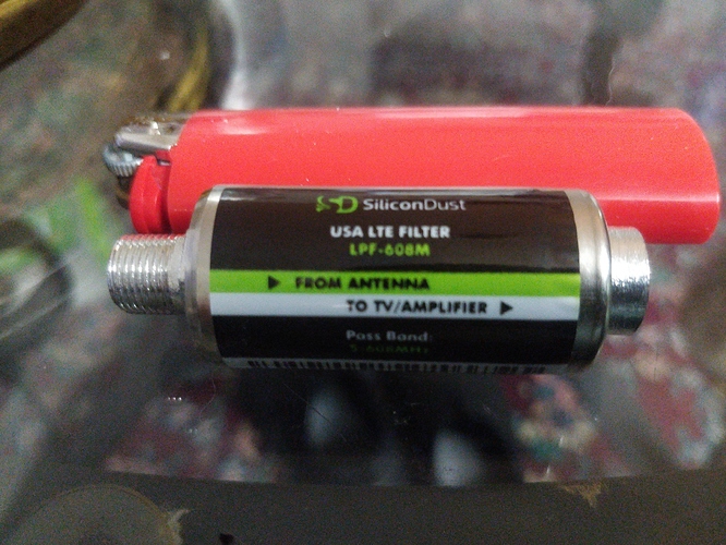

Starting to get the stuff I ordered. Not sure if anyone has this one, but we're fixing to try it out.
Awesome. I was told that the closer to the antenna you place the filter the better results. No idea why that's the case, but it's what I did.
