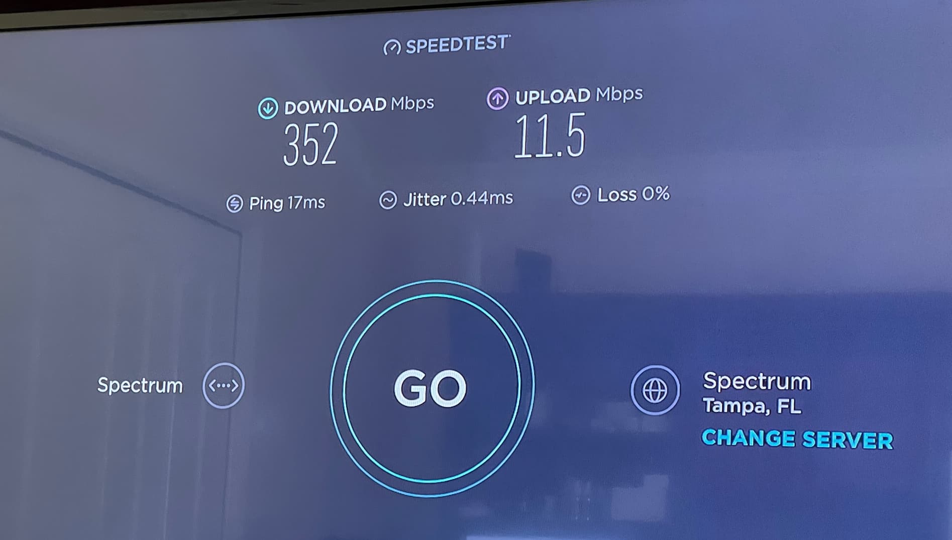

I have my tuner (HDFX-4K) on MOCA 1. I have an Apple TV 4K on MOCA 2. They are in different rooms. I have a MOCA/Cable RF AMP/ Filter on my entrance point for my home. All Coax terminates in the low voltage closet. My internet is 300 Mbps down and 10 Mbps up. This is a screen shot from Apple TV on MOCA 2. I have 7 channels clients running in my house along with Smarthub, security cameras, Doorbell..etc. I had lots of issues with the ActionTec units. I tried a Motorola from Prime and no issues with the tuner. Added a second just to see if my media room liked it...and it did. While I have no proof the ActionTec's are questionable, I know the Motorola MOCA devices are solid.
