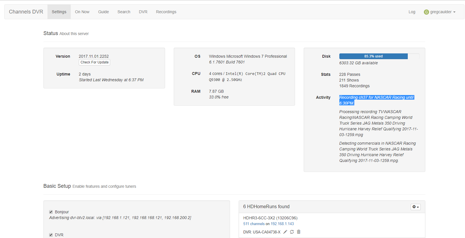

I am seeing a log of sporting events being recorded in SD, when they were also broadcasted in HD on the appropreate channel.
One example is NASCAR Racing, and NFL Football.
I did have another strange issue were the DVR though FOX was on a strange 1000+ channel but it wasnt FOX, so i have only that option to disable the channel to allow recordings to start again.
Right now NASCAR is recording on channel 37, when it is also in HD on channel 720, chanel callsign is NBC Sports Bay area.

It tried starting the recording on channel 720, but it got a 503 error. Now the question is how to solve that issue.
