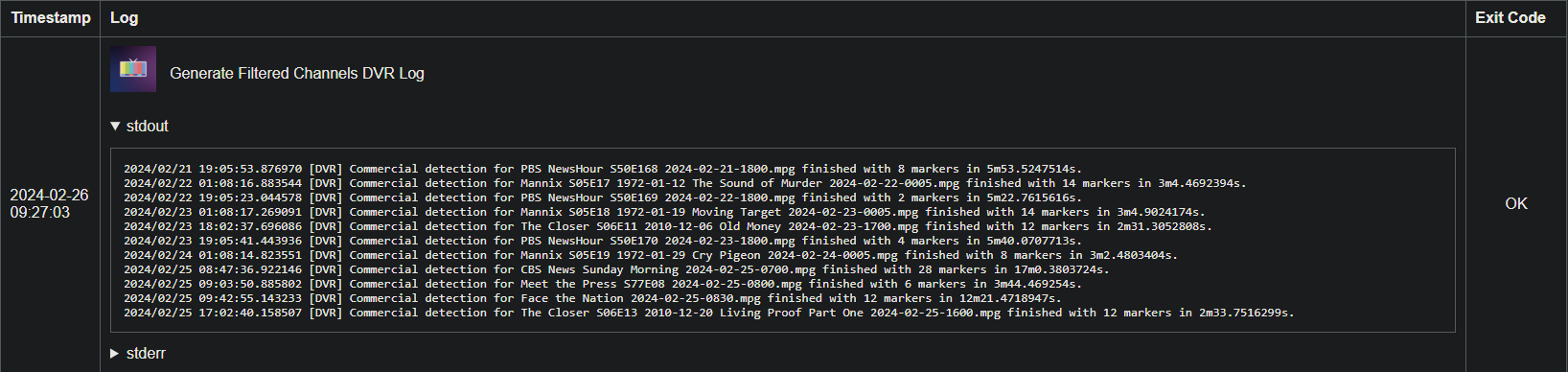

I wonder if you're not being a bit too aggressive with your Comskip processing. Maybe try backing off on the number of threads you're allowing Comskip to use:
Good suggestion! Let me back it down to 2 threads.
I get good results with 1 thread running in a Proxmox VM. Keeps temps down too:
Thank you everyone for your help. I think I have the problem solved. I just ran a test recording 6 shows at once, 4 from TVE and 2 from HDHomerun. No buffering or dropped issues! See below:
