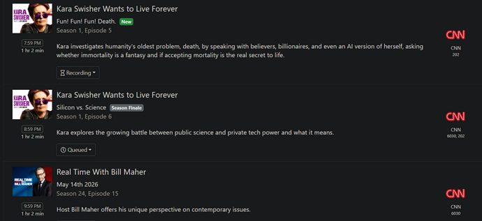

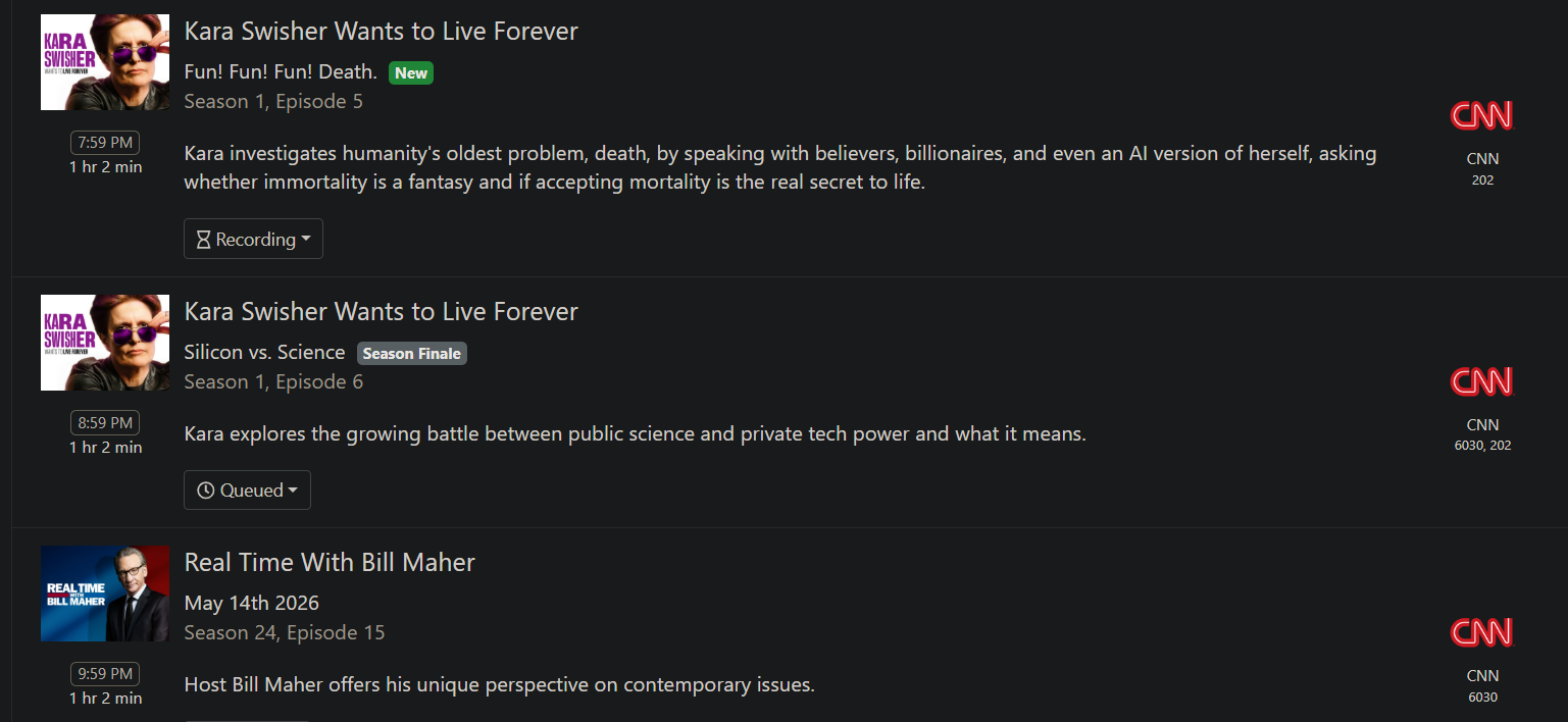

updated yesterday to 2026.05.12.0935. it seems my directv stream TVE source is not being respected as the highest priority source. Logs have been submitted as 5dd286c3-945d-4aa8-b588-e6f9cf74bc73 .
it's possible it's something i did, but I've tried re prioritizing the sources, disabling/re-enabling, deleting/recreating the db. I have not done a pc reboot, but that I can do that if anyone thinks it'd help.
while grabing this screen shot I noticed bill maher did not get sheduled on tve with the db rebuild several hours ago. so that explaines it, but not the new pass I just setup for 'Kara Swisher Wants to Live Forever'
iirc the channel #'s are showing in priority order and should be 6030, 202
ok, so jobs in progress only show the channel it is actually using.
the later bill maher was a manually set recording via the guide only showing the tve source.
also these recording passes are set with series id, not channel.

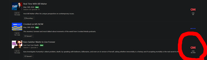

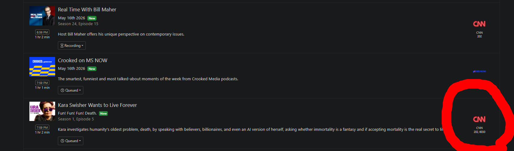

that explains why my schedule looks correct now, since my last post I went ahead and favorited all the wrongly numbered tve channels I care about. (6###)
