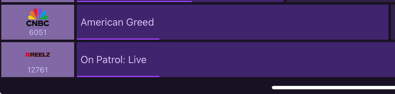

Ok I’m all set except one item, I keep trying different numbers but not quite there
I would like it to be on grid as channel number 44
#EXTINF:-1 channel-id="REELZ" tvg-chno="44" tvc-guide-stationid="6095"REELZTV
https://cdn.katapy.io/cache/stream/reelztv/reelztv/720.m3u8
This is result everything works except sit at position 12761
When I put 44 in channel id it messes up guide…
So I went back to reelz letters and below is what I see ..
only way to get is is to download the app and cast to to the big screen now bummer.

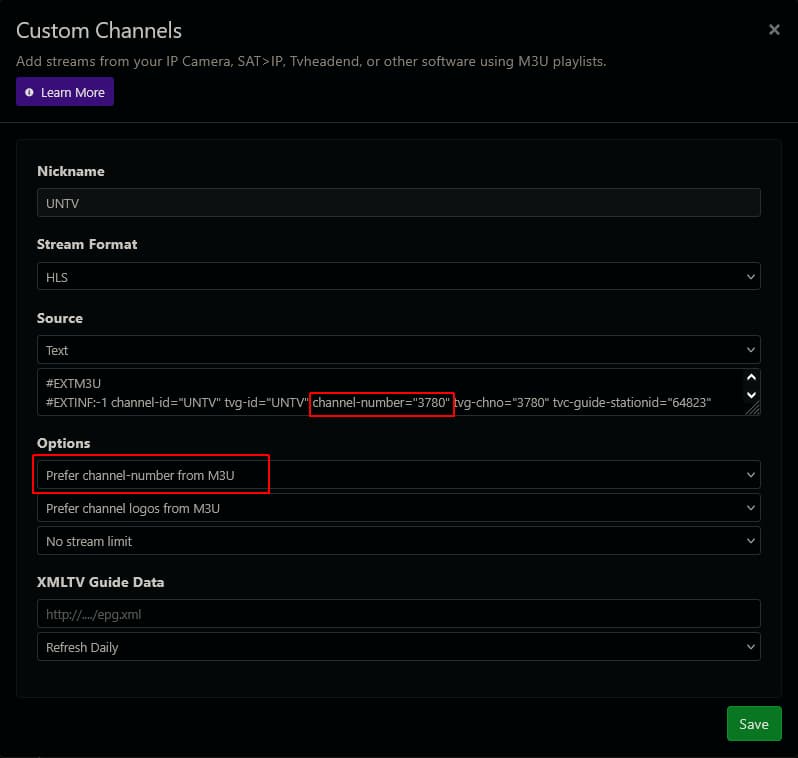

Is that (ch 44) conflicting with a existing channel from another source? Use a number that does not have an existing channel.
Once u set the number in the m3u, use the Delete and Re-Create the Guide Database to clear out old channel numbers. That is what i had to do.
Also, fully close and re-open the Channels app on your clients. They need to refresh properly. on Apple TV, that is double press the home button, then double press up.
You need a comma between tvc-guide-stationid="6095" and REELZTV
tvc-guide-stationid="6095",REELZTV
Also make sure your custom m3u source setting is set to Prefer channel-number from M3U
