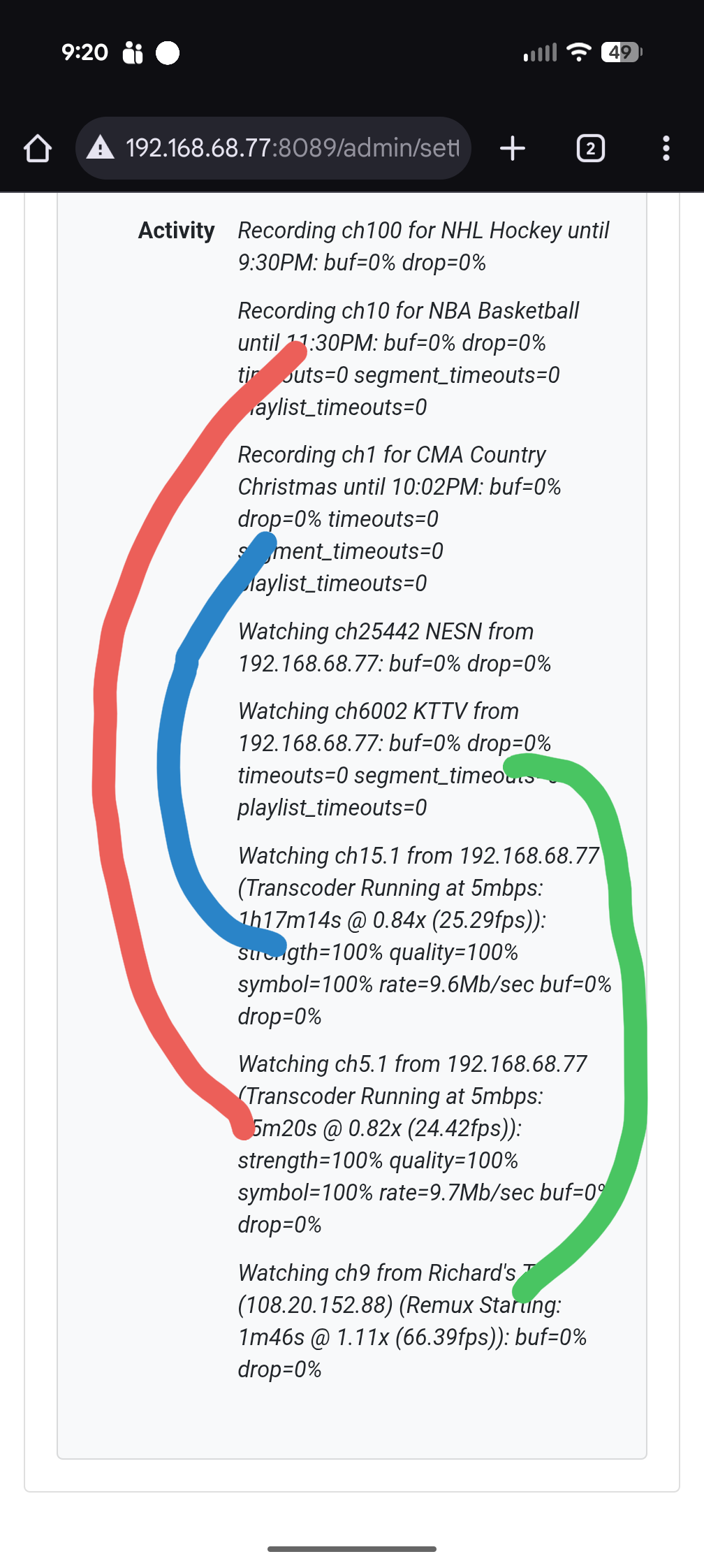

I posted a thread earlier regarding why under Status in the Channels DVR server I see the channels being watched, but also how they're being transcoded at 5mbps. Most of these are being used at Home with a direct feed ad original quality.
A user mentioned that possibly Playlist is causing the watched channels to be transcoded.
Is there anything with Playlist Manager causing this? Am I over oooking something? The graphic below links the stations. You'll see the original with its OTA channel code and then the revised numbering. I just don't understand why it's transcoded and why I'm seeing two for one station.

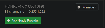

Disable your HDHR in Channels if you are using PLM to feed those stations in. You can't delete it (believe me, I tried and it just came back), but you can make it not used. It'll look something like this:
If you have two sources with the same link to the stream, Channels will show that "both" are playing, even though only one is. For instance, this is what PLM is feeding for me in the m3u:

And that link is exactly what Channels would have with the built-in HDHR functionality.
It might not be; it could just be an artifact of this situation. Here's me watching direct (VLC):
And here's me watching in the web (which forces transcoding):
In other words, Channels might be interpreting what is happening as a web-play, therefore it shows the Transcoder running.
Otherwise, if you are still seeing it, another reason it might be transcoding locally is if you are using the on-server buffer:
This makes sense. I was pulling the m3u for my two HD Homeruns from Channels. How do I pull it directly from the HD Homerun instead of through Channels DVR? Is it the IP Address . m3u or something like that?

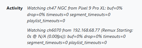

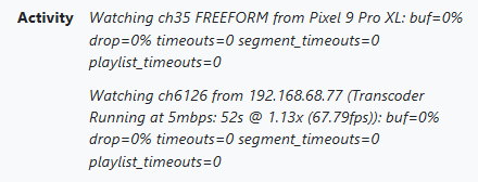

Also what's interesting is the TVE stations either trigger a remux or a transcode. Any ideas what would cause that? I have the stations for TVE being brought into Playlist as MPEG-TS, but aren't the TVE stations likely HLS? Below are clips of TVE stations playing at home on my phone. You see the two stations pop up. The lower channel is the renumbered channel from Playlist while the 6000s are TVE from likely Channels DVR.
Example of TVE Remux (National Geographic)
Example of TVE Transcode (Freeform)
