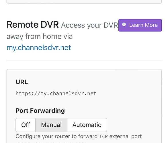

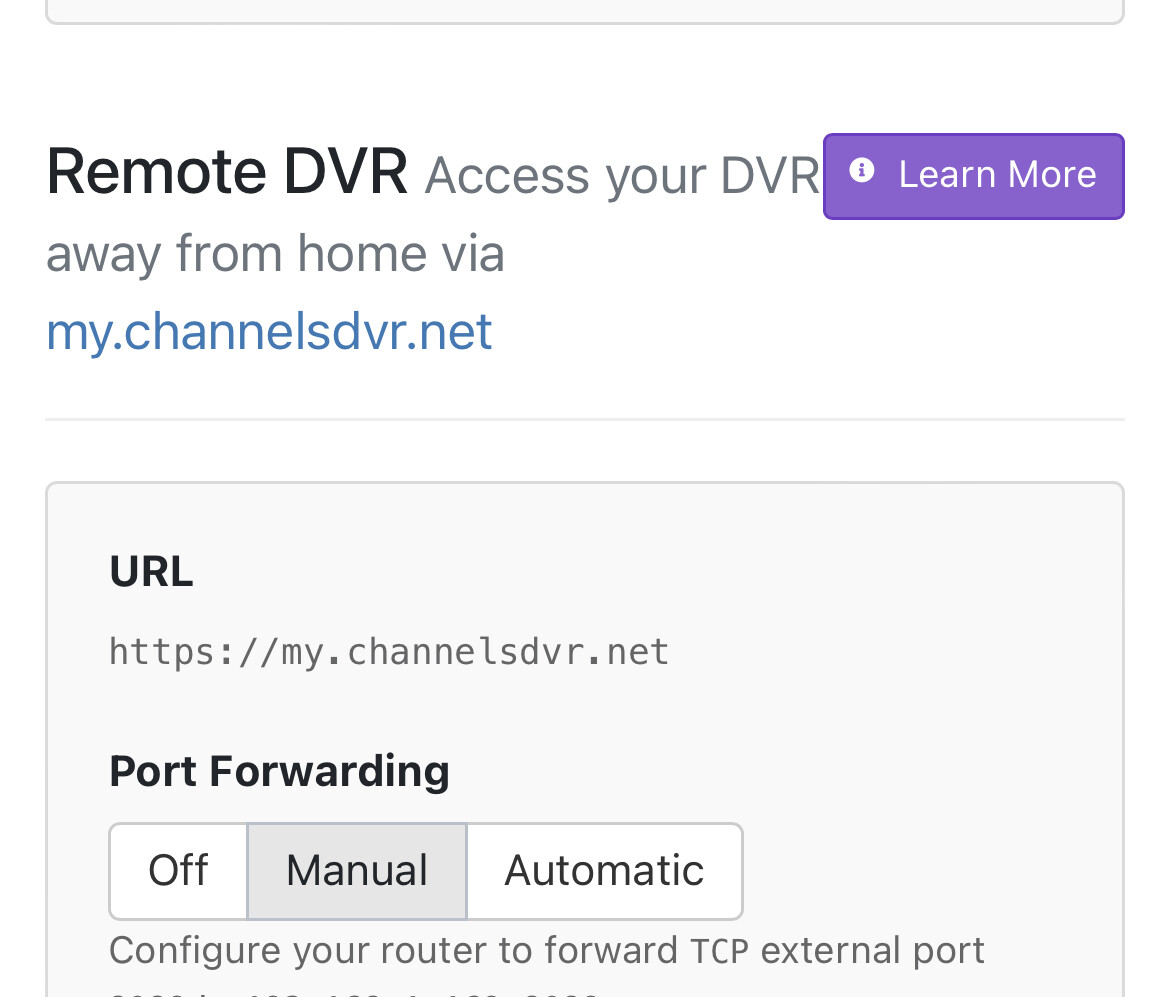

Hello. I’ve had this vexing problem now for about 6 months. I’ve triple checked my router settings to make sure port 8089 is open. No matter what I try I cannot get either live OTA to stream or any TVE channels to stream. Local playback is no issue.
Any insights and thoughts appreciated.

On the mini dvr settings try toggling to off then back to manual, verify server ip in the router forwarding is correct. Hopefully you set up a static ip for the mini. It might have changed on you. Are you running any firewall in the mini?
I did this yesterday. Toggle on/off. Yes, I have a static IP address for the Mac Mini.

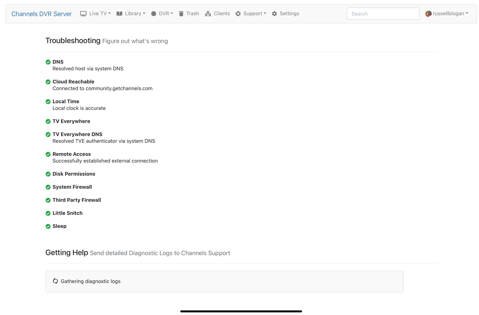

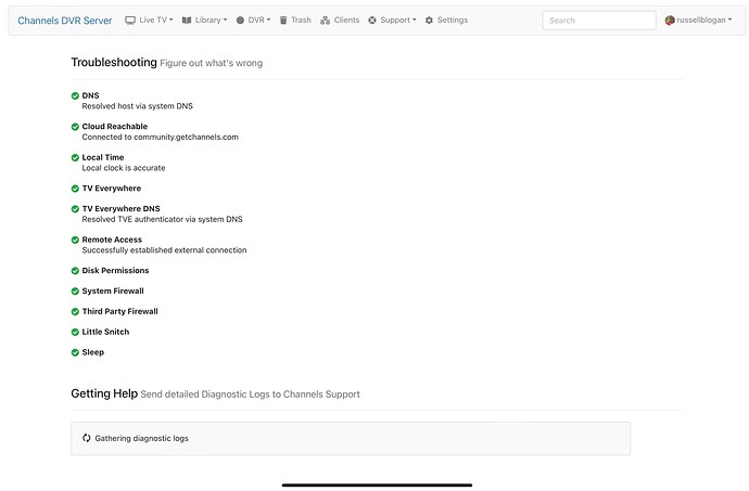

Do you get all checkmarks if you go to dvr settings page support >troubleshooting
Thanks. Yup. All checks.
My guess is that it’s little snitch or firewall. Beyond disabling them to test that I don’t think I have any more suggestions
