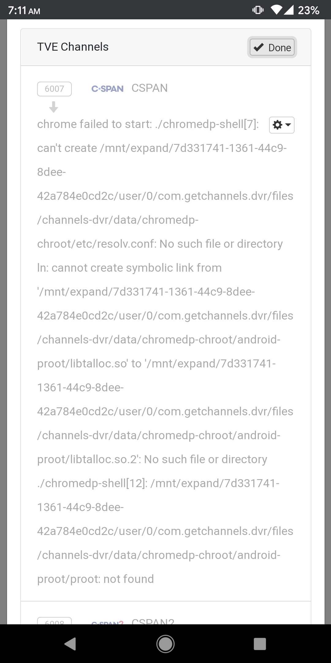

I'm not familiar with what is being referred to here without more research, but I am also having issues that indicate chrome is the problem. Several channels produce this result:
How should I workaround this? Keep removing / reinstalling different chrome versions until it's solved?

This thread is about using the dvr on macOS and unrelated to your shield issue.
You can click and hold the Sign In button after entering your TVE login to reset the chrome install on your shield.
