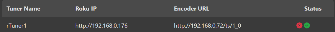

Trying to setup this up for the first time. I have a single HDMI encoder and a Roku Streaming Sick (4k version, super thin). I've configured 2 different channels, 1 from Fubo and 1 from Philo, but can't get either to work. Did a little digging and it seems like the encoder is connectiing but not the Roku stick. I can confirm it's working, I've checked the IP address on the device and can manually tune things, but when trying to tune through LiveTV preview function in the docker web admin page, it only shows me the screen saver from the Roku app.
I did have to go into the advanced settings and change ECP to enabled so that I could lookup the App IDs. Is there another step that I missed?

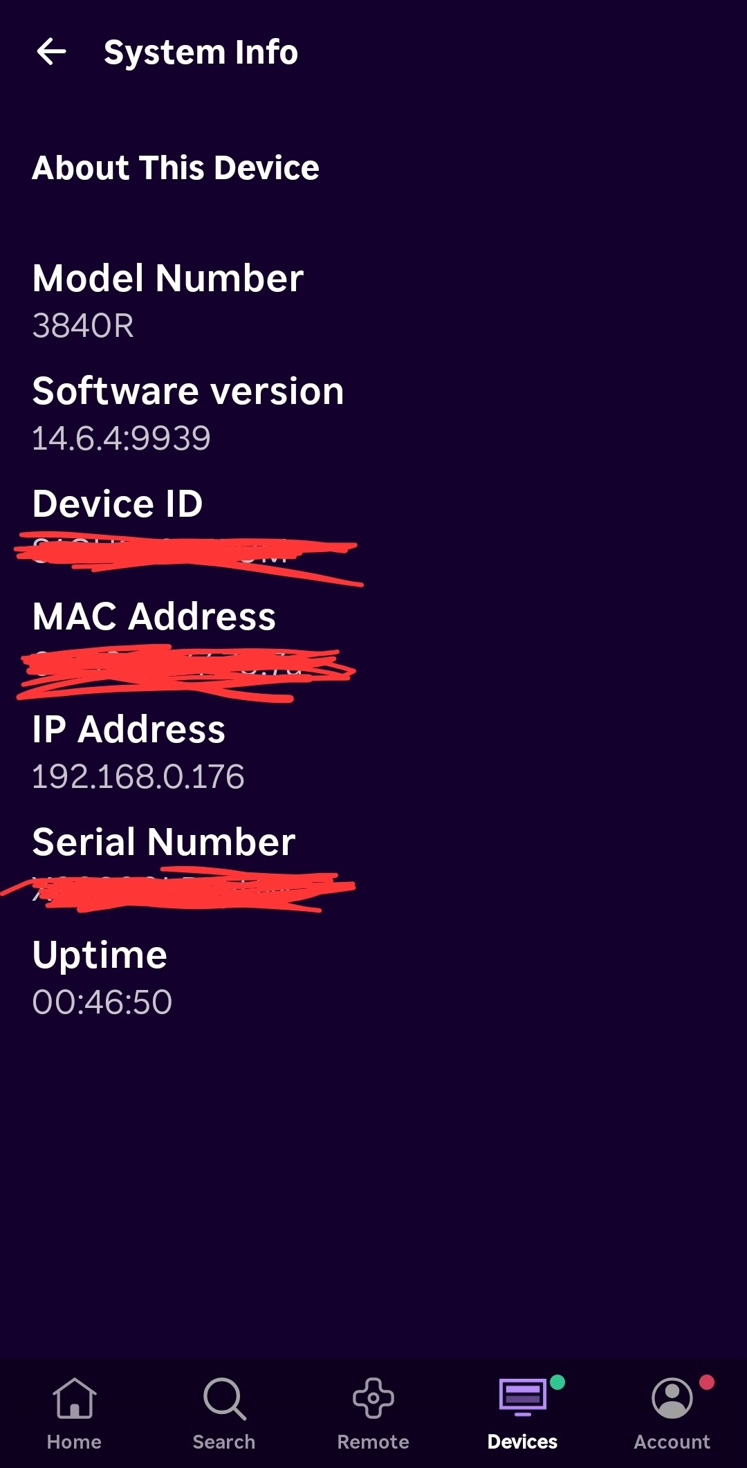

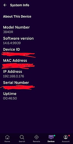

Here's some screen shots showing the IP settings for the Roku but still not working. Any advice on how to resolve?
Try restarting the Roku. If you have the correct IP and have followed these steps, it should work

Confirmed IP both before and after restarting the device.
I had it set to Enabled but switched to Permissive (no default option available) and restarted the Roku. Still not showing as connected in the docker.
Also double checked, no conflicting IP addresses.
Edit - Connected to Phone app, can confirm it connects and has the correct ip address.

Thank you for the logs. How did you install the roku bridge? Did you use the docker run command or install it through Project One Click? Also, what are you running docker on?
Edit: Also, would you click Save All Changes on the status page and see if you get an error or a confirmation. Download and view the Configuration file, look for something like this:

I updated the main repo to increase the status check timeout in case that was the issue and I added better error checking for the tuners. Update and see if this fixed it or gives you an error.
