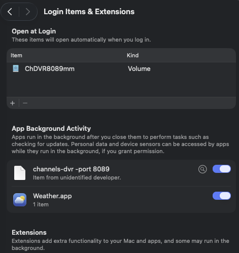

I turned off File Vault and set my user to autologin
I think I have it working. Time will tell.
I'm not seeing the permission popups for CDVR network access when it updates with CDVR running as a system service.
I have my autologin user mounting my Synology SMB shared folder (that CDVR is writing to) on login.

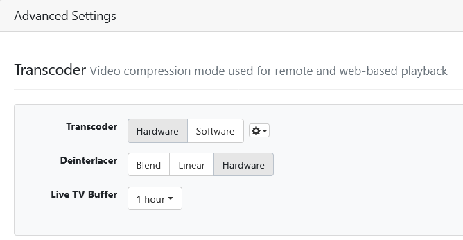

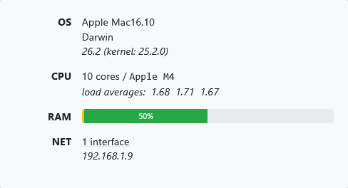

I have it running as a system daemon and it's allowing hardware transcoding.
Maybe because the user that installed it is logged in?
Screenshot 2026-01-10 at 21-55-13 Channels Settings
Screenshot 2026-01-10 at 21-55-39 Channels Settings
Hardware Transcoder Probe
h264_videotoolbox

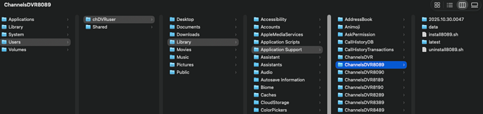

I installed CDVR as a background Daemon and it was working.
But I'm unable to create another Channels DVR instance running in the background.
Since I wanted to install other instances in differnt directories and using different ports, here's what I did.

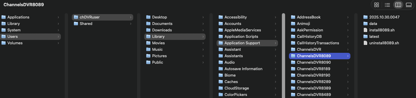

Uninstalled the background Channels DVR Launch Daemon.
Copied the folder CDVR was running in /Users/chDVRuser/Library/Application Support/ChannelsDVR
to a new folder /Users/chDVRuser/Library/Application Support/ChannelsDVR8089
Renamed and modified the install.sh in the new folder as follows

Used terminal in the directory /Users/chDVRuser/Library/Application Support/ChannelsDVR8089 and ran ./install.sh
It ran and created the plist file /Library/LaunchDaemons/com.getchannels.dvr.8089.plist
