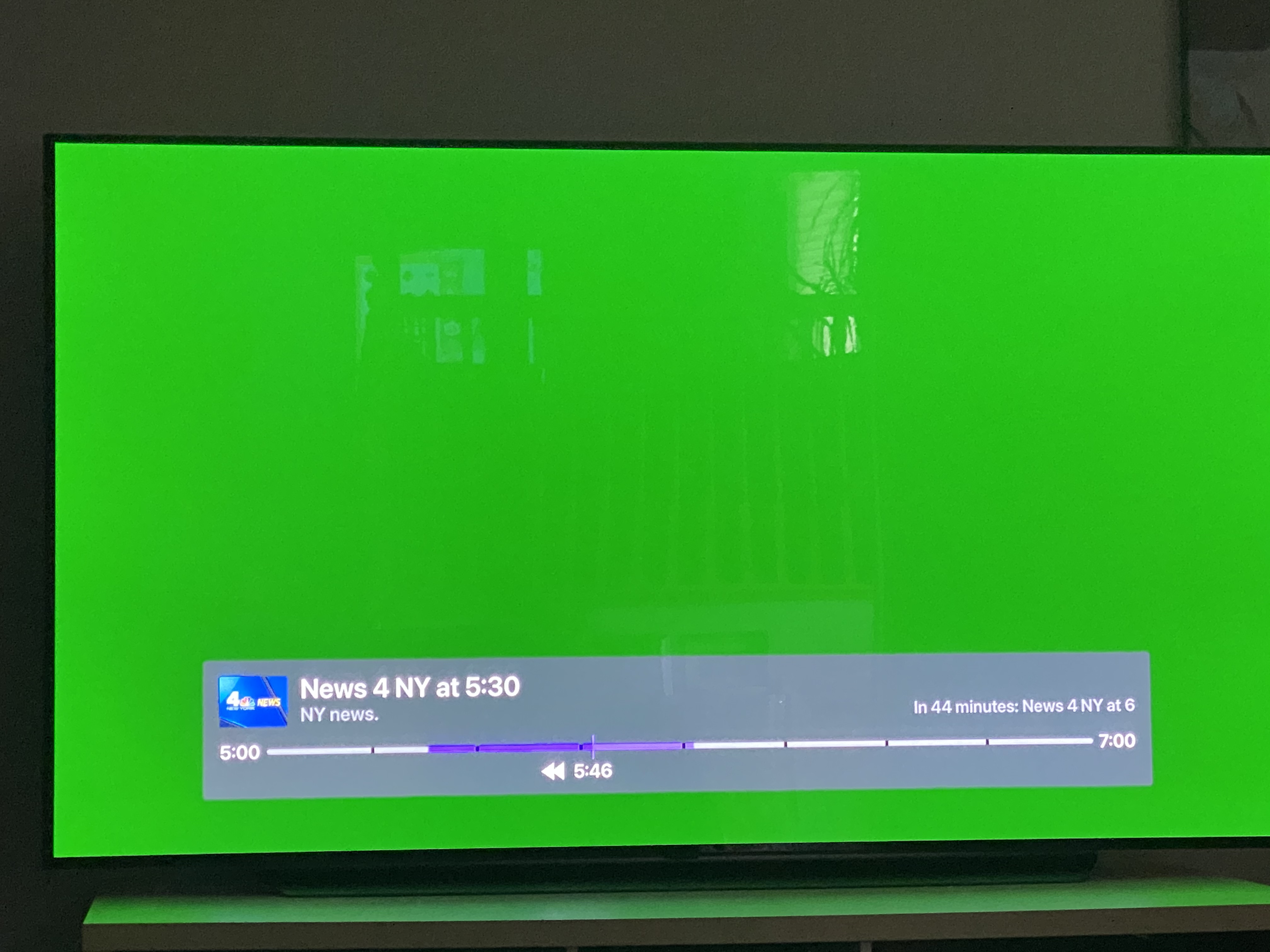

This is getting bad. Fast rewind, holding the trackpad turns the screen green and stays there. Trick play stops responding and it keeps rewinding.
And no, it’s not the hdmi cable.

Can you try switching back to the Default video driver?
Sure thing, but I have to step out. I’ll try later.
it works fine on the default video driver, i cant replicate it. i can easily replicate it using the experimental. thanks.
Thanks. What about with experimental video driver but Linear deinterlacer
these setting work, i cant replicate the issue. thanks.
An update to my very slow/jumpy rewind/fast forward issue of live recordings on ATV 4K - I switched the video driver back to the default (from experimental) two days ago when I saw the advice above and the performance improved immensely. I had actually forgot I had made that change long ago.
