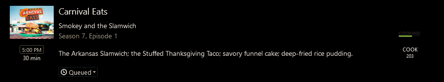

Created pass 'Carnival Eats S07E01 test' to record Carnival Eats - S07E01 - Smokey and the Slamwich
Enabled Re-record deleted episodes
Pass shows two Matches are airing
06/18 17:00 30min COOK 203
06/18 21:00 30min COOK 203
Scheduled
2023/06/18 11:28:59.382632 [DVR] Rule 'Carnival Eats S07E01 test' (677) found 1 new airings
2023/06/18 11:28:59.432957 [DVR]   queued recording job for EP019509620130 @ Sun Jun 18 5:00:00PM on ch=[203] (1687132800-677)
2023/06/18 11:29:00.224294 [DVR] Waiting 5h30m59.775716264s until next job 1687132800-677 Carnival Eats
/dvr/programs "EP019509620130": "queued-1687132800-677",
After changing the scheduled 5pm recording from Queued to Skipped, it still shows as queued
I assume it's queued to be Skipped and will change to Skipped after the scheduled recording time has passed and that the scheduled job will be deleted at 5:30pm
After the 5pm scheduled recording time passed, /dvr/programs changed to skipped
2023/06/18 17:00:00.005128 [DVR] Skipping job 1687132800-677 Carnival Eats
/dvr/programs "EP011117850134": "skipped",
Pass still shows 9pm airing Queued
Carnival Eats test - Pass5_202306181746
Schedule still shows 5pm airing Skipped
Since the 9pm airing isn't scheduled in /dvr/jobs, I doubt it will record. I'll edit the post again after the 9pm airing is over
9:07pm and nothing new in the log
/dvr/programs still shows "EP011117850134": "skipped",
Pass No longer shows any airings
Carnival Eats test - Pass6_202306182107
