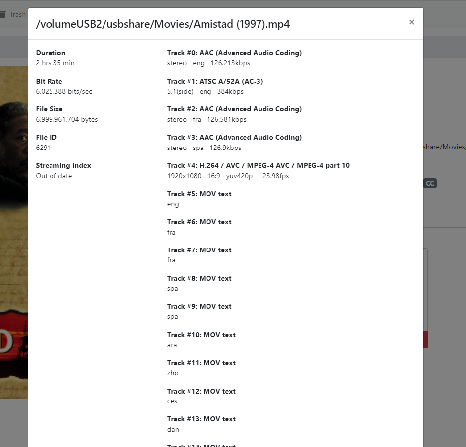

Find the imported video, click View Details on the web UI and screenshot what is shown.
And after playing and only seeing black, click Settings > Support > Submit Diagnostics
Screenshot attached. I am clicking on "settings" and nothing is happening. I've submitted diagnostics before, but for some reason, it just takes me back to the Channels DVR home page.
I was able to open up the logs and there is nothing shown for this movie when I get the black screen. But, if I transcode the movie, it appears on the log.
