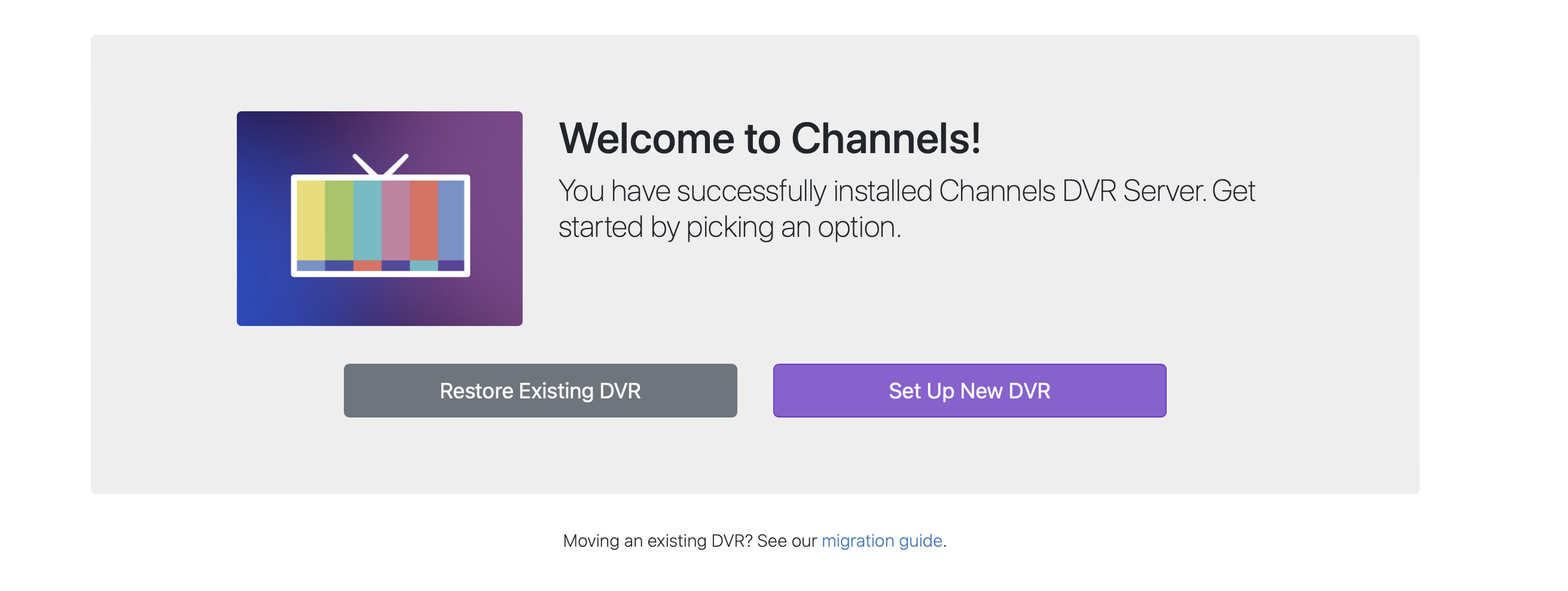

When I visit xxx.xxx.xxx.xxx:8089/restore I see

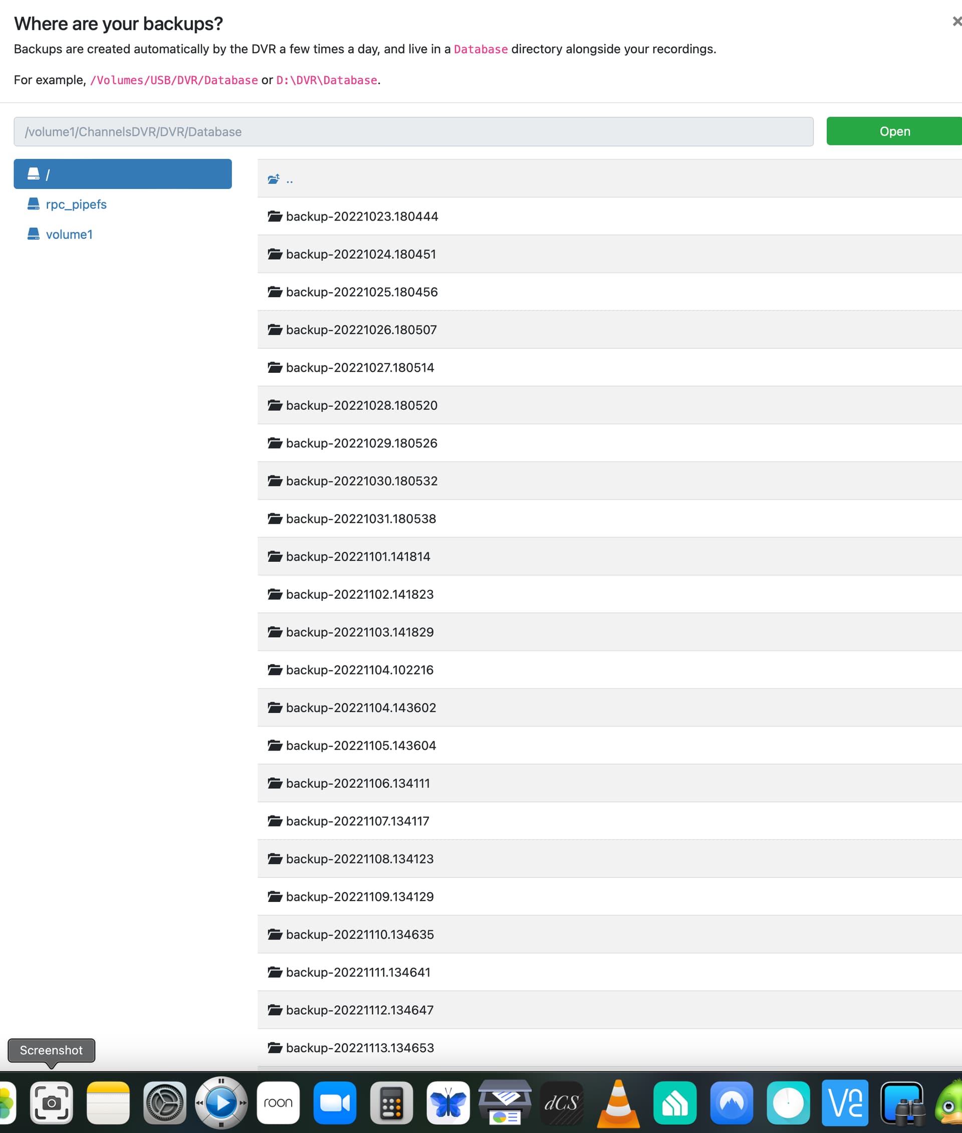

I then open Volume1/ChannelsDVR/Database and see
So now I'm not clear on how to "install" anything. Seems this backup location was maybe a dummy when the code was installed?
You need to pick the directory you put them in.
/volume1/ChannelsDVR/DVR/Database
Nope that takes me back to the page with the backup that has nothing in it...
Seems like I need to take the second option Set Up New DVR, right?
Use the restore link he gave you and pick the directory where you copied your backup to.
Did you actually read the article on how to restore?
Pick the backup that you want to restore. You’ll want to use the most recent backup.

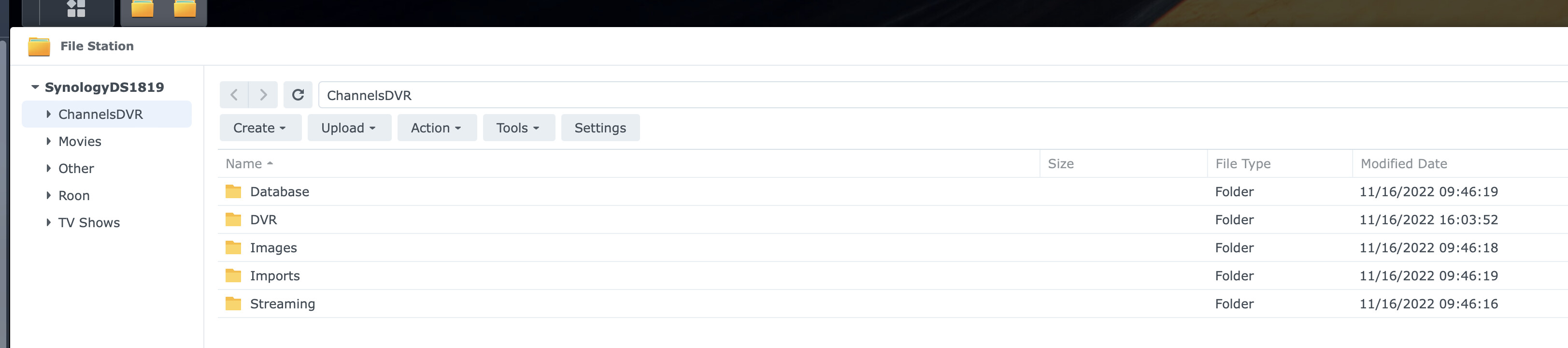

So, I should move everything you see here into the ChannelsDVR folder?
That is to move everything within the one here called DVR into the one above. Do I need worry about duplicate folders already there???
No. Thats the folder you want to move things TO.
Correct
No
Then what exactly are you saying I need to move or not?

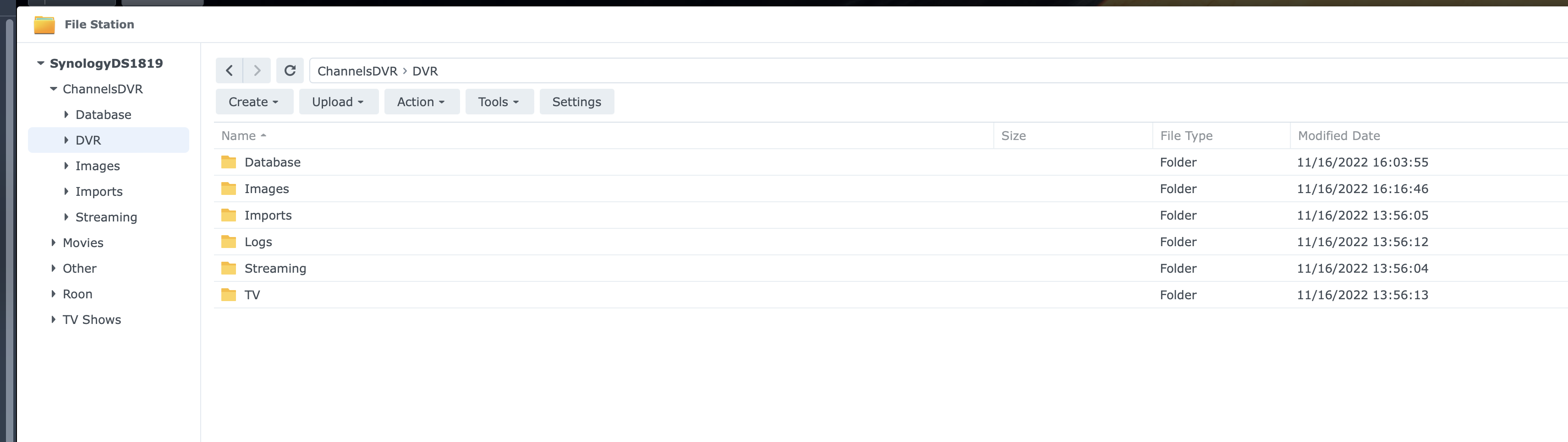

This is within the .../ChannelsDVR/DVR folder:
Are these the folders I need to move up the ChannelsDVR? If so, some will seem to be duplicate names. Or do I need to first remove the ones in ChannelsDVR that have the same name?
Yes
That is correct
Originally you should have copied everything inside the DVR folder you now have to /volume1/ChannelsDVR
But instead you copied the DVR folder there.
OK. So, I'll first remove the duplicate named folders in ChannelsDVR and then move everything from the lower DVR up.
No,
Just move them like I said.
