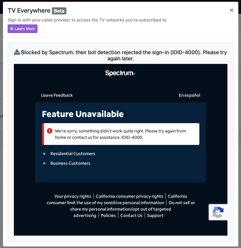

I've gotten some back, but now get this error.
I am getting the same error. I will just wait a while and see if it goes away.
Got the same error about "bot detection" now. For some reason TNT/TBS/TRU now are working, but everything else fails with that bot error.

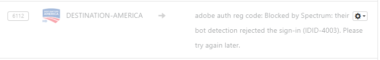

I've tried this with version 2026.08.06.1842 and some channels are still experiencing the bot detection message in the logs (Discovery, HGTV, Magnolia network).
2026/08/06 20:02:59.171256 [ERR] Failed to start stream for ch6104: TVE: adobe auth reg code: Blocked by Spectrum: their bot detection rejected the sign-in (IDID-4003). Please try again later.
2026/08/06 20:04:02.589728 [ERR] Failed to start stream for ch6101: TVE: adobe auth reg code: Blocked by Spectrum: their bot detection rejected the sign-in (IDID-4004). Please try again later.
Logs have been submitted as b164170e-9af1-4ec0-a0cd-447a5dfe5e7d .
