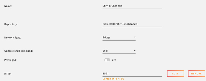

I installed it just fine in UnRAID last night. Config looks like this:
Using search on docker hub I can't seem to find it
How did you search
Go to your Docker page and hit Add Container in the lower left. Then just enter the settings same as I showed in my prior screenshot and you’ll be good to go.
