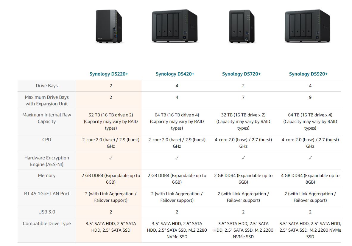

I went with the DS720+ and never regret it. The two drives comes in handy if you want redundancy this way if one drive fails the other will save your data. If you are going with Synology I would recommend the DS218 + or the newer DS220 + with a memory upgrade. I got the DS720 + for the 4 core processor the DS220+ is 2 core just a little extra power.

You would need to spend about $500 to $600 bucks for a NAS Plus (+). It may be over kill for your use unless you plan on Video or Music Library.
