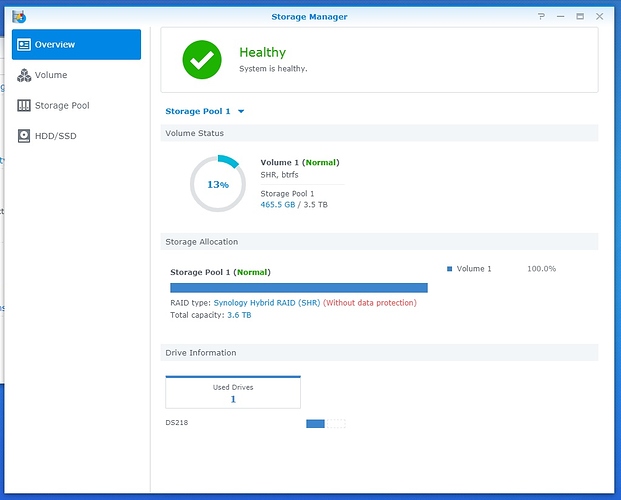

I understand that I need to get to RAID0 or JBOD, the problem is that when I look at the DSM and I use their help app, it says to open the storage manager app/storage pool tab. it then says to select a storage pool then click change raid type. there is no provision to select a storage pool and the only option available in the drop down is change settings. change raid type is greyed out.

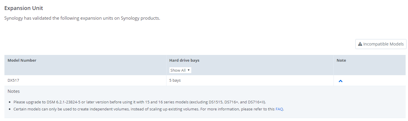

DS218+ does have an eStata port. I don't think I would use it for expansion but use it for faster transfer of data.

You cannot change raid type from SHR to RAID0 or JBOD. You would need to completely remove the volume and recreate with these raid types. If you keep it as SHR, a second drive will be a mirror.

Additionally, the eSATA is for connecting to a DX517. This would allow you to add 5 drives, but as a separate volume. It is not intended to attach a single drive.
It doesn't work as an expansion on the DS218+, hence the "2" in the "218" part of the model name. It can be used as an additonal volume of 5 drives, but will not expand the main volume to 7 drives like you can do on a DS718+, nor 9 drive as you can do on a DS918+... etc.

I'm confused and I feel like this has gone around in a circle or I missed something or I asked the wrong question. below is a screen shot of my one drive. my original question was if I could add another drive to be used as a separate drive not linked to the first and I thought the answer was only if I restart everything to RAID0 or JBOD. the reason I didn't want linked drives is because I thought if the drives were linked without data protection, if one drive failed all was lost on both drives.
You need to restart everything if you are going from SHR to RAID0 or JBOD... these are array types for combining drives. But you can keep your 1 drive and add a 2nd as a new volume.
