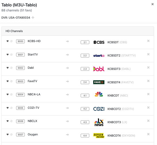

Got Tablo running thru Docker, unfortunately, I can not get a guide so I can record tv programs, I have enclosed screenshots of my setup, how can I fix this.
Try Guide Maintenance > Refresh
Thank You :smiley: that solve the issue

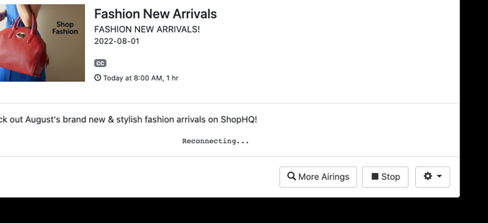

I have a new issue on Tablo I get reconnecting how do I fix that since I can not connect to any channel?
I get this on TVE for Tablo

Got Tablo Back in Sources unfortunately, I getting on web Browser Reconnecting message and on The TV app I get this message Playback Failed (17), how do I fix it?
Check the docker logs to see if there is some error
Does the regular Tablo app let you watch?
Thanks for replying the Tablo App works I don't see any log for Tablo in Docker only MLB
After seeing that error on the TV, click Settings > Support > Submit Diagnostics on the app
I Summit Diagnostics on the app to Support just now.
Edit the M3U source and make sure Type is set to HLS (not MPEG-TS)
Thank You very much it works great! :grinning:
