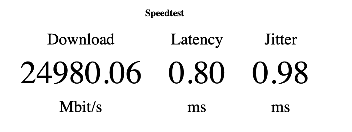

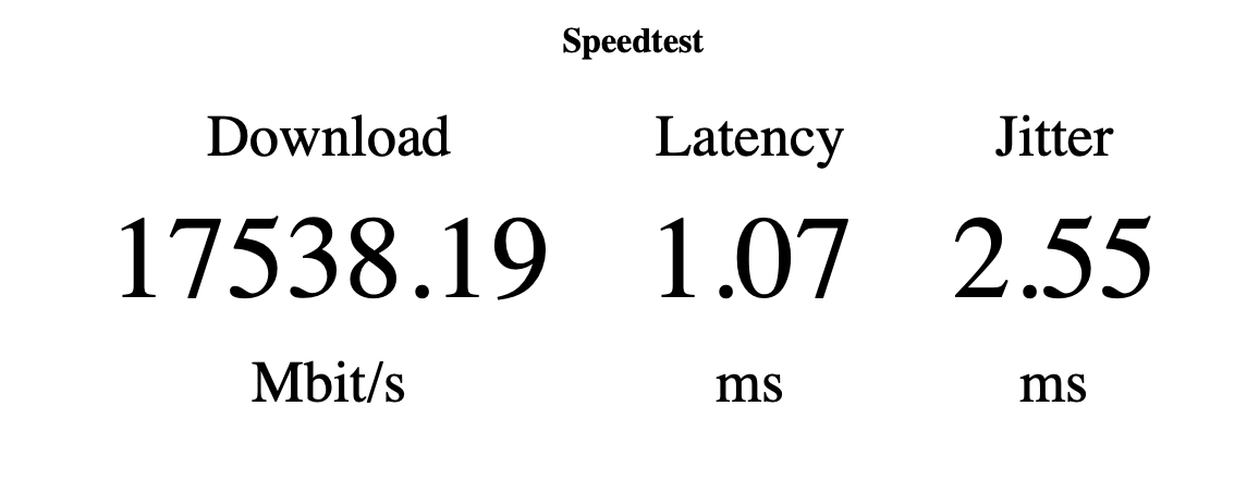

I opened up configure to channels server page and ran speedtest on 127.0.0.1, the results and attached screen test. Tried to run the same test from my iPhone and came up with safari cannot open this page. could not connect to the channels server.
That address basically means "this computer". So, a high value is expected, because the data never leaves the computer. That's also why that IP address won't work on other devices. You need to use your computer's actual IP address (probably something like 192.168.X.X).

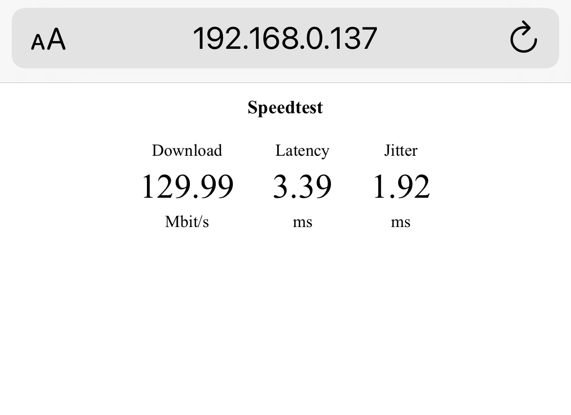

Ran speediest on my Network IP. 192.168.0.137

You need to run the speedtest from a device other than the system running the DVR.
That's a bit more realistic. Especially if things are running through a 100Mbps router.
