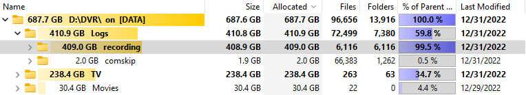

Which files in particular in the Logs directory are taking up all of the space? In each subdirectory under the comskip directory is a video.mpg file which may show as taking space (but actually isn't), but is only just a link/reference to the actual recording.
The idea that a bunch of text files are consuming 60% of your drive is ludicrous, so I thought perhaps this situation might just be a misunderstanding. (That's not to say it isn't possible, just merely improbable. If your text files are indeed consuming that much disk space, then I'll just retreat.)
It's the debug recording log files in Logs/recording
They can get quite large logging TVE and M3U recordings.
