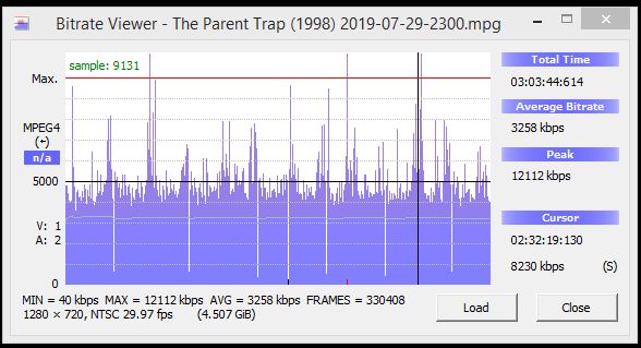

Is this the same Bitrate Viewer you used?
https://www.videohelp.com/software/Bitrate-Viewer-2
Latest version
2.3 (October 7, 2011)
Does VRD Pro offer anything like that?
Yes, that’s it

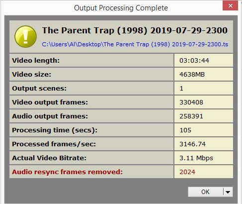

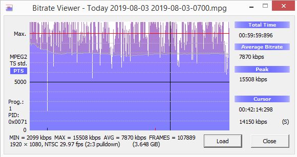

So I've played with this some more today. I installed the latest official release build of VideoReDo TVSuite 5 (I actually had a license key for it from many years ago). When I open my test "Mama's Family" recording from above it does allow me to edit it without crashing, and processes it the same way you all describe with all the resync frame removal errors. Going through the files you can clearly tell the promos/commercials are sometimes in a super low resolution compared to the actual episodes.
I'd say AeroR1's "Bitrate Viewer" is confirming the same behavior I'm seeing, just in a different way. Those areas in his files where the bitrate bottoms out I'd be willing to bet are these low resolution commercials and promo insertions.

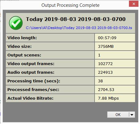

For me, Windows Explorer eventually comes back and the system is usable again. VideoRedo is able to open and process the suspect files. When running Quickstream Fix, it's always removing some number of audio frames to resync. Never have had issue with video frames. The Quicksteam Fixed version of the file plays nice with both Windows Explorer & Channels DVR.
I forwarded @reneg's log to VRD support and here's what they said:

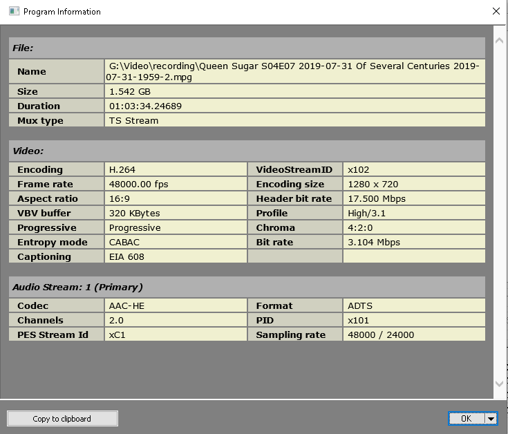

Thanks for the log. The problem is that the file's video stream has a frame rate of 60 fps, but time stamps in the PES packets are increasing at a rate of 59.94. Can't tell which one is correct although if the source file plays in sync in VideoReDo then it's likely that the video stream's frame rate is incorrect.
Try this: Go to Tools>Options>H.264/HEVC options and change the Source frame rate from "Automatic" to "From stream". Then right after you open the file click on Tools>Show Program Info. Is the frame rate now showing as 60 fps or 59.94?
For the file that matches the VideoRedo Log file, it is showing 60 fps.
After Quickstream fix, it shows the following
I have another file that shows 48000 fps which causes problems with Windows Explorer,
On this second file with the VideoRedo options set to "From Stream" instead of "Automatic". I run out of virtual memory when trying to Quickstream Fix it. When I change the option back to Automatic, VideoRedo can process it without running out of memory. Most of my Channels DVR recorded files that don't cause problem are 29.97 fps.

Don't know where in the stream VideoRedo and comskip get the frame rate of 48000.00 fps, but they both do see that.
On all three of these VideoRedo SaveAs or QuickStreamFix will remove about 1,000 audio resync frames.

VideoReDo Source frame rate "Automatic" and "Calculate" shows 29.97 fps
VideoReDo Source frame rate "From Stream" and "From Container" shows 48000.00 fps

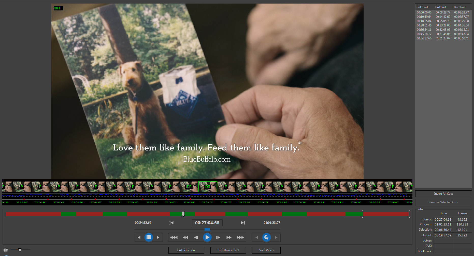

Using the same recording I inverted all my cuts in VRD so only the commercial blocks would be saved and I saved each of the 6 blocks (seen in green) one at a time. cb1.ts - cb6.ts. Every block gets audio resync frames removed.

It's not the dogs fault.
For this recording at least, case closed.
Each of the 6 commercial blocks contains the following encoded at 30 frames per second, where the rest of the recording is at 29.97 fps.
I think the reason why some software (including Windows) is getting confused with these TVE streams and thinking the video frame rate is 48,000.00 fps is because the audio stream is first (lowest pid, first stream) and the video stream is second (higher pid, second stream) and sees the audio sampling rate of 48,000.
Most ts streams have the video as the first stream and the pcr is usually on that. With these TVE streams the audio is the first stream and has the pcr on it.
