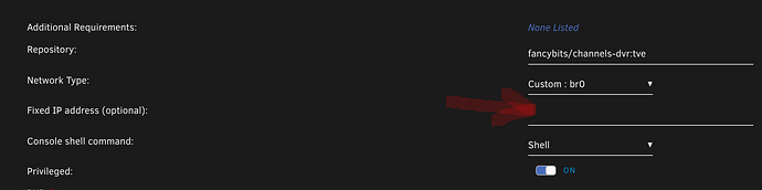

That's not valid with --net='Bridge'. Can you please do the run with the network type that you have in the screenshot and then post it, including the IP address?

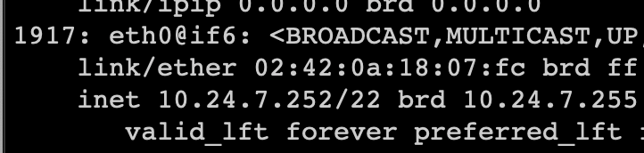

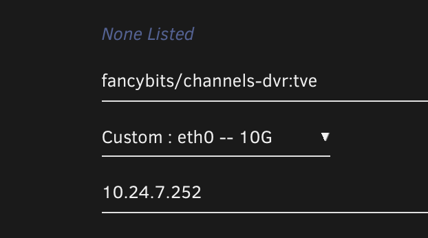

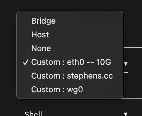

Bridge mode isn't in the same subnet. The channels docker container is going to be a 172.17.0.0/16 network. That's why I said see what the IP address in the network is. See here:
What you're trying to do is give it an IP address in your own private network, which you can do using the eth0 interface (if you're running default without changing it). Mine's named 10G so I choose that one in the list, give it an IP address in my network,
Screen Shot 2024-12-26 at 16.31.35 PM
Screen Shot 2024-12-26 at 16.36.13 PM
Now I can ping it from any device in my private network. You can't get in the same subnet without using the interface network or a bondX network
