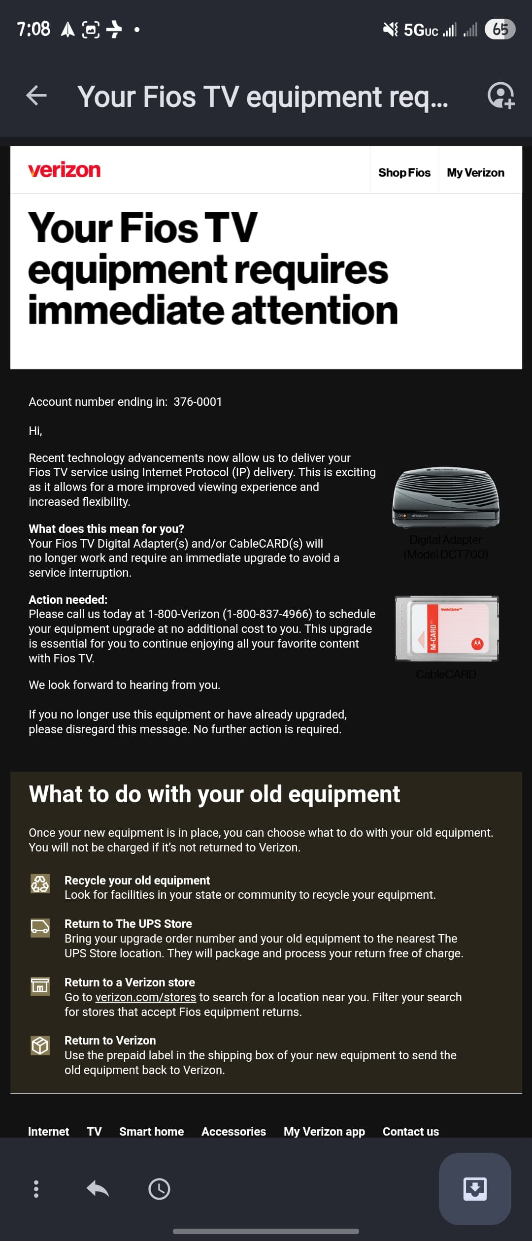

Verizon Fios sent out email to Boston, MA customers. I received the email last week.
Thank you,
Can you post the email?
