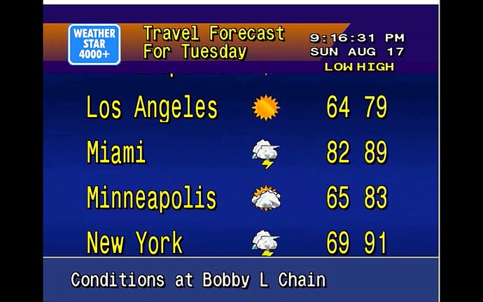

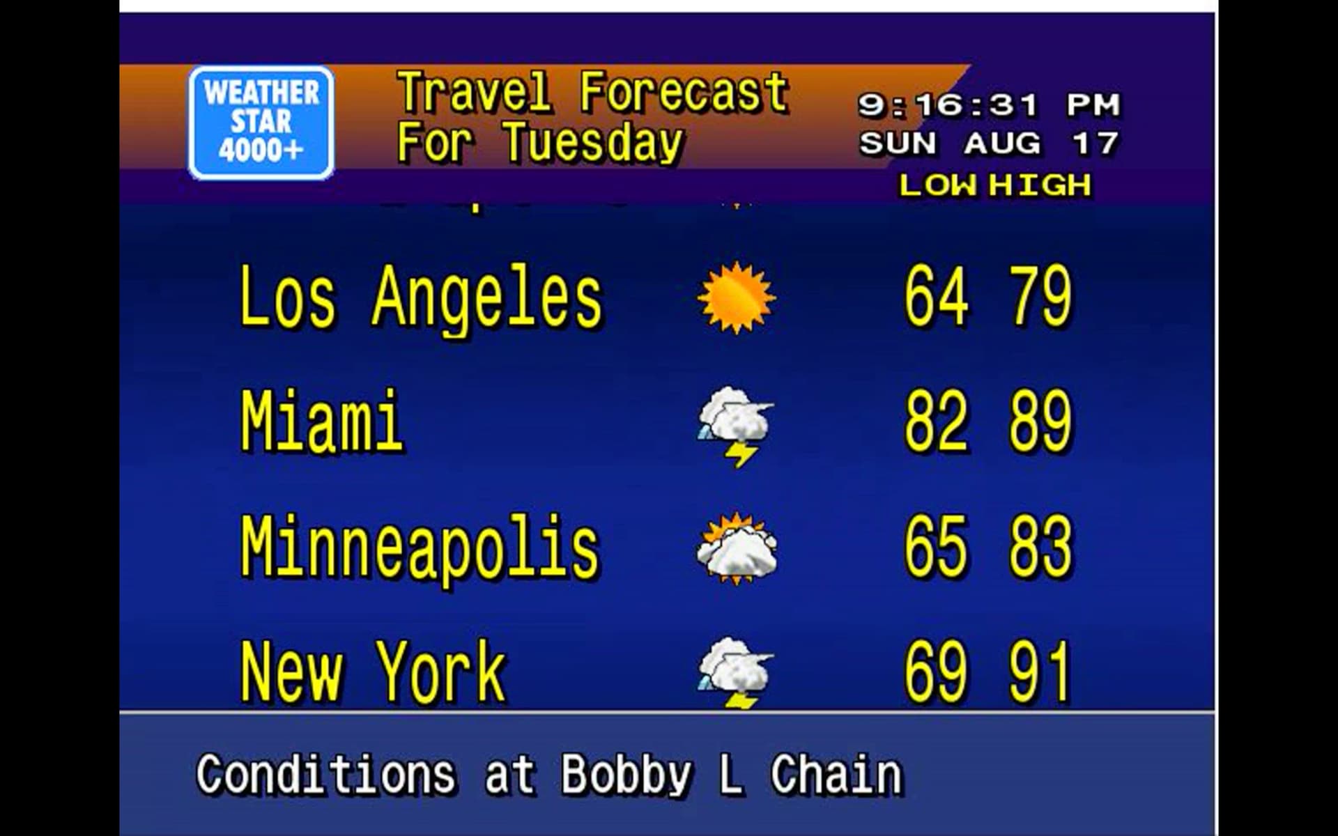

The reason I’m writing here is to say that I’m also having the issue with the white outline on the top and right side of the video. As with Accursitver, I am also running it on an Ubuntu Server (24.04). I noticed it after I recently performed a docker-compose pull.
Try deleting the container, the container image, and reinstall using the updated pull instructions on the ReadMe here. Make sure docker run and pull do not have the latest tag.
Thanks for the quick response and for the help! I stopped and removed the container, adjusted my docker compose, and reinstalled using the pull instructions. After I started the docker, I'm unfortunately still getting the same white lines:

i just updated my ubuntu server and now getting these strange white lines too... i'll mess around - i suspect something with ffmpeg? just straight guessing
In your quoted code you reference the latest tag. Did you update to latest on accident?
well, i thought of that... did a clean install and still getting the bars. it's almost like the bars arent "bars" - it's like the whole image was drag and dropped down and to the left (hope that makes sense) exposing the white on top and right hand side.

curious- how does your cropping logic work? wonder if something i updated today changed how your software crops?
I spent about 95 percent of the time it took to build the app on dialing in the cropping. It basically uses x y coordinates. There isn’t anything you can do with the cropping as it’s baked in. @Accustiver was able to roll back after seeing the lines. Mabey he has some tips, if you use portainer you can select the images tab and delete or roll back to an old image. The SHA numbers will be different then the GitHub sha though inside portainer. Portainer shows the local image id.
tnx...
AND -> go figure - i went through a ton of troubleshooting with ChatGPT and didnt get anywhere except after a fresh reset/refresh of the container for the 50th time, it magically worked..
from the robot machine:
So the white sliver was almost certainly a transient viewport/layout artifact (headless Chrome sub-pixel rounding, a scrollbar/margin, or a page state) that disappeared when the browser session was reset by the container recreate.
My apologies...I actually am still getting those white lines even with an older image too. Not sure what else to try other than what @KineticMan suggested from ChatGPT
