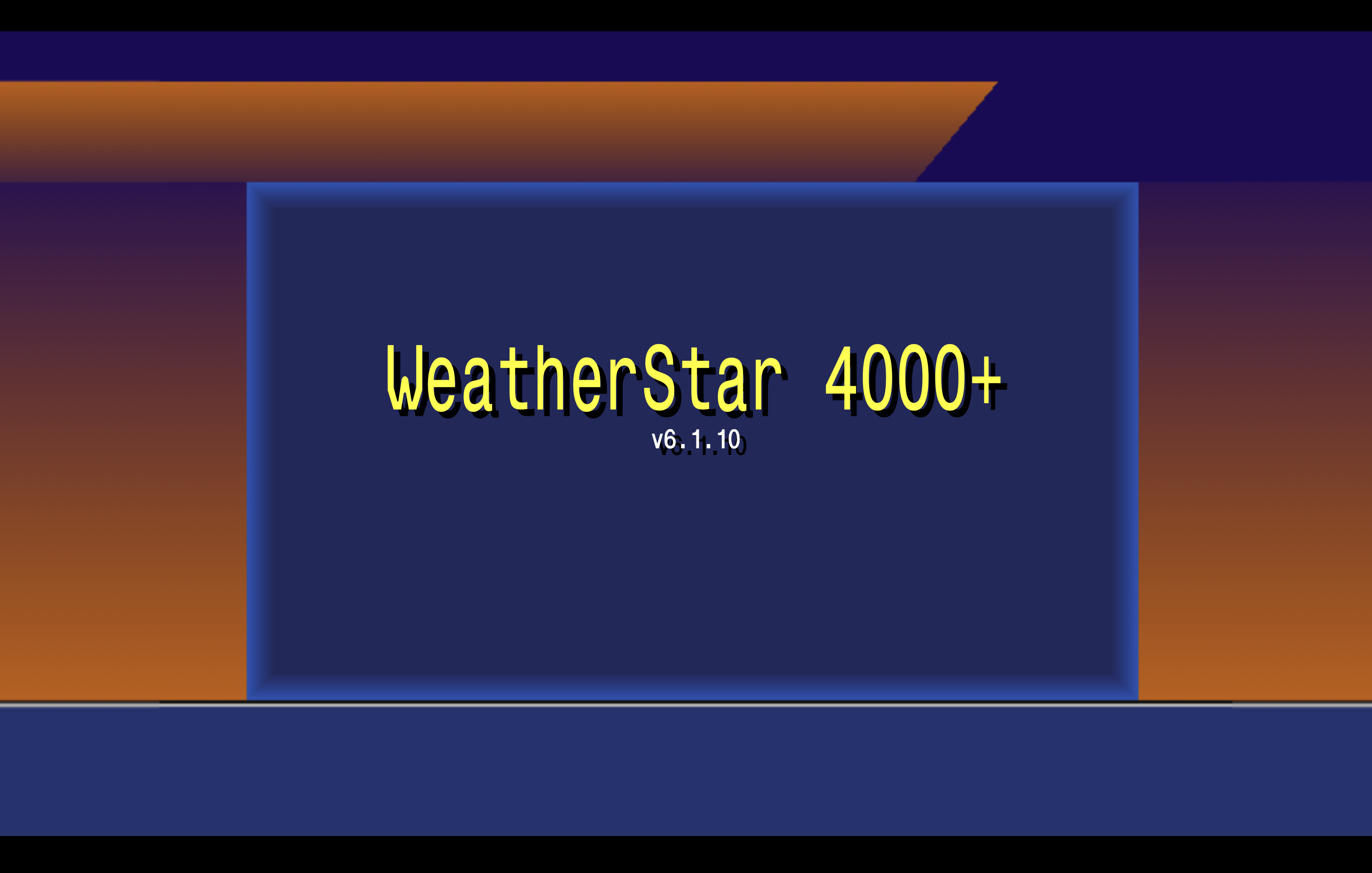

I've added the above to OliveTin-for-Channels' Project One-Click. Fill-in a few fields and click -- the container is downloaded, the Portainer Stack configured and the CDVR Custom Channels Source created!
screenshot-htpc6-2025-09-06-16-04-54
screenshot-media-server8-8089-2025-09-06-16-21-47

Now all I get is the WeatherStar placeholder, with no actual data. I scanned this thread, but I'm not sure where to go from here.
Described here:
Even though you're not running the container version of cc4c, you still need to follow the couple of steps described in Chrome.
