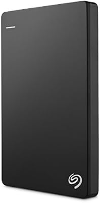

This is the drive I am using, a Seagate Backup Plus Slim 2TB. It gets its power from the USB bus:
I was going to put a USB style power cube like that from a phone charger on the power side of this USB Y adapter. Do you think that'll work?

That cable looks like it takes the feed from the computer and splits it into a data+power stream and a power-only stream; in other words, the opposite of what you want.
If your drive does not have a separate discrete power input, I believe your best option is to put a powered hub between the Shield and your drive.
