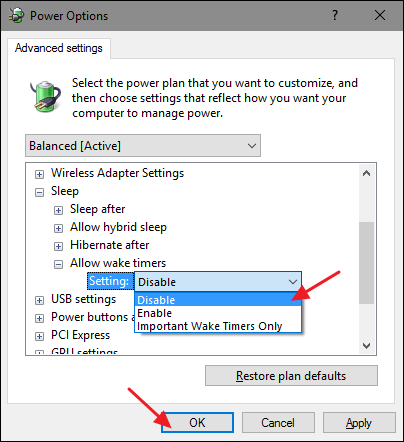

There's experimental support for waking up automatically to make recordings, but you have to turn on the "wake timers" feature to "enabled'.

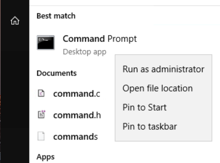

Looks like you can run powercfg -requests in an Administrator console to see what's keeping your machine from sleeping.
I tried on my machine and it didn't list anything. Then I started a DVR recording, and channels-dvr.exe showed up.
When I stopped the recording, the entry didn’t go away. So it looks like there’s a bug.

It’s supposed to wake up 3 minutes before the recording starts.
See it you can get a list of wake timers somehow. The DVR also tries to wake up for maintenance tasks like downloading guide data, so that could be why it woke.
