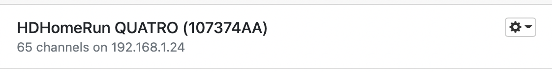

at least log into the settings and see if the channels service is showing an IP address associated with the HD Home run.
Yeah, it shows my 3 HDHRs correctly.
