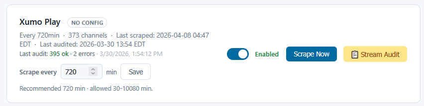

So can you make an epg and m3u? How does blc work with channels
Hmmm vlc-bridge-xumo seems the EPG is no longer working.
That project is dead, time to move to FastChannels for, well, everything:
