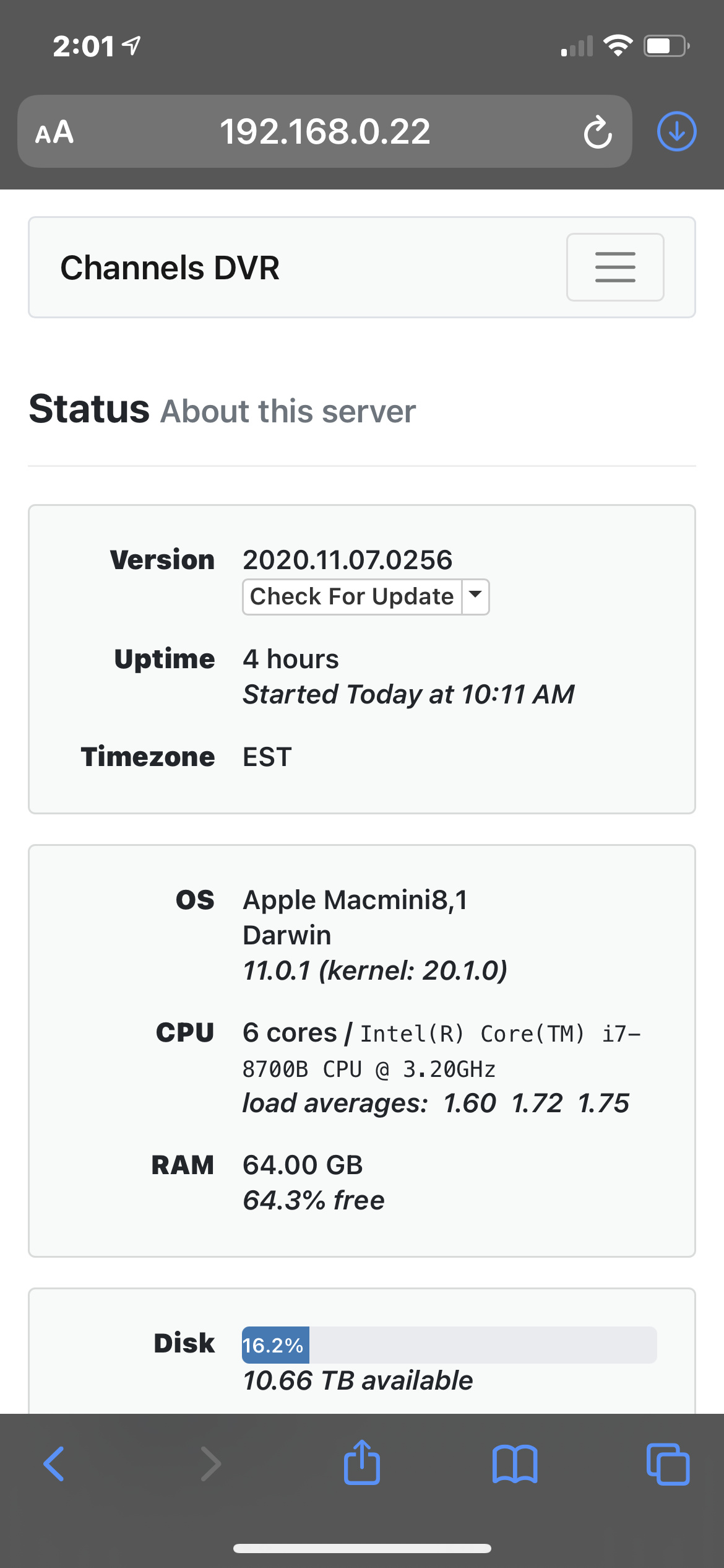

Interestingly, if I manually type the internal URL of my server http://192.168.0.22:8089 in web browser (Safari) on a wifi connect iPhone, it is able to connect (I see the server status page), but when I set the up the client app with the same URL get "Error, Channels DVR Server was not found at http://192.168.0.22:8089"

Yet On the same device this website loads
