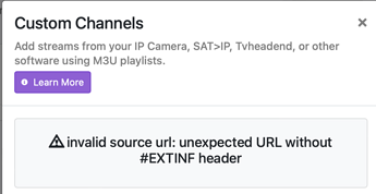

Could you post an example of your m3u8 that works for a livestream? I'm having problems getting to work using the example posted in Youtube Livestream - #15 by alai
This is the error I get when trying to create the custom channel.
This is what the m3u8 file looks like after getting the URLs from the "youtube-dl -g" command on the YT livestream URL. Note long URL is truncated.
You're mixing up m3u and m3u8
In the custom channel you still need a m3u pointing to the m3u8
