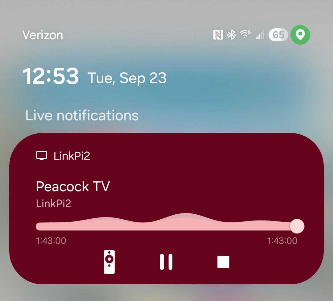

I have used a less sophisticated method when I'm at home and not feeling like going upstairs to the room where my tuner stack is. I use the "Let others control your cast media" setting. Then, you can use your phone or other device to stop the playback. Just hit the stop button:

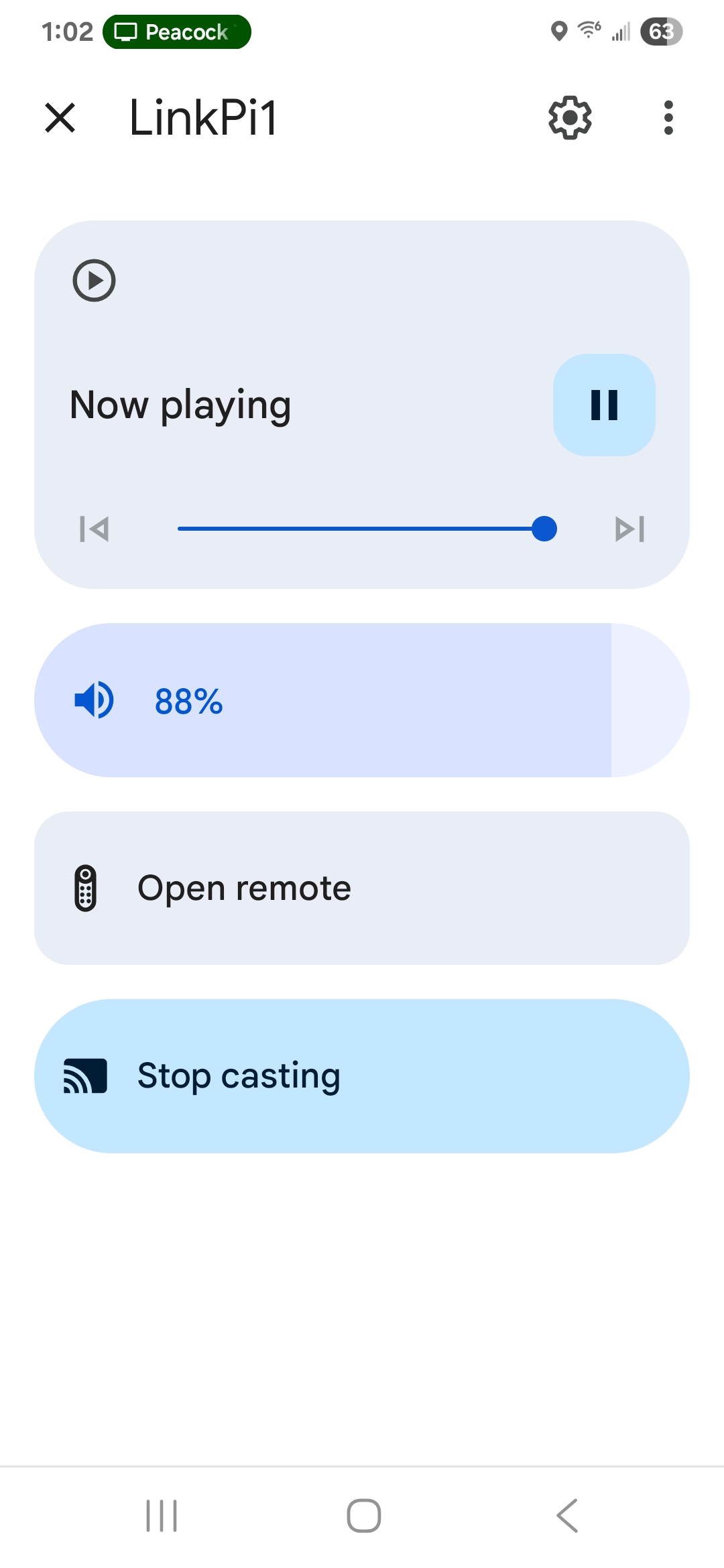

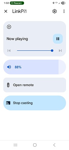

I have also used the "Stop casting" control available in Google Home for the same purpose. It's not a reboot. But, it usually sends the tuner device back to the home screen: (I think that this method also works remotely)
