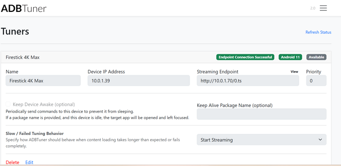

So, I am trying to install ADBTuner to use FDL with. I've got the endpoint correct, on Android 11, but the Availability is grayed and not blue.
I also didn't get any virtual channels thru Project One click.
Suggestions appreciated.
Good progress. It'll be blue when there's an active stream -- gray is fine with no active stream, when the other two are green.

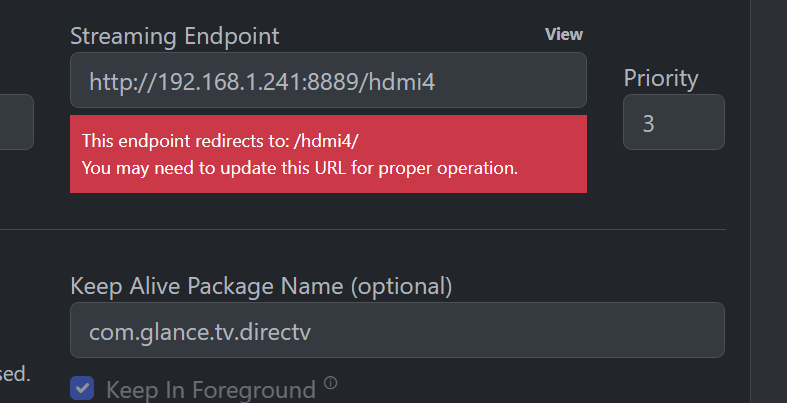

I am trying to use my MediaMTX and my BlackMagic Quad Decklink.
I am currently getting the following error and trying to figure out what it may be looking for

The error message indicates that it’s redirecting to /hdmi4/ with the trailing slash at the end (you are using /hdmi4 when it should be /hdmi4/). What happens if you use that URL? I don’t know anything about MediaMTX, but it looks like it supports MPEG-TS streams so make sure you use whatever URL maps to that format.
