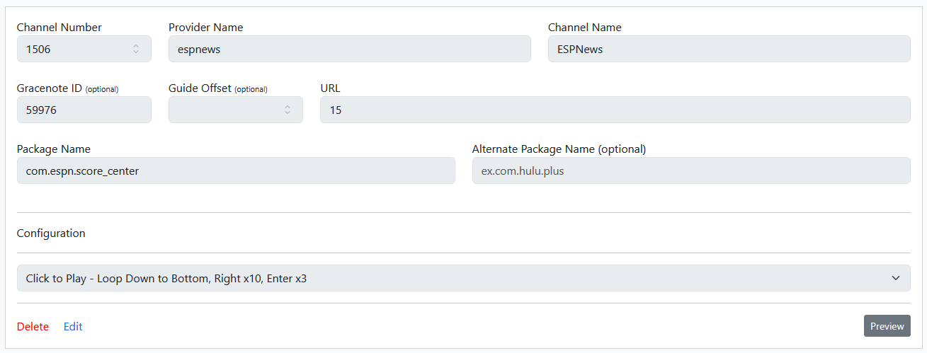

Well, I suppose a little preview is in order! Let's look at ESPNews, for instance...
The Configuration tells you the steps that are going to be run, but we'll get back to the rest. First, the global options are set so that it starts streaming after 1 second.

This is because these steps can take quite some time and we don't want Channels or anything else retrying a bunch of times. It's best to have it streaming and you can watch the automation happen, like a ghost moving things! This, too, allows users to see something is happening and not think it's just spinning its wheels.
Next we use the pre-tuning commands to get us a clean slate.
    "pre_tune_commands": [
        "am force-stop '||TARGET_PACKAGE_NAME||'"
We definitely want to intentionally force stop the app because we want to make sure we are always opening in the exact same spot before making movements. This, in turn leads to starting the tuning commands.
    "tune_commands": [
        "monkey -p '||TARGET_PACKAGE_NAME||' -c android.intent.category.LAUNCHER -c android.intent.category.LEANBACK_LAUNCHER 1",
        "sleep ||TARGET_URL_OR_IDENTIFIER||",
Here, it's pretty similar to what you found where Monkey acts like an app is being clicked to open. It's very important to do this as then you don't need to know the default page. Note the ||TARGET_PACKAGE_NAME||, which is the variable for the app name. This way, if another app has a similar setup of action steps, you can just reuse this one. Hasn't come up a ton yet, but there have been a few.
Similarly, the sleep to cause a wait is using the variable ||TARGET_URL_OR_IDENTIFIER||, which is derived from the URL field above since we are not using that for anything else. When you save a station for the first time, it seems like you have to put a textual link, so I just keep entering http://thing.com. Then I've just edited it immediately afterwards and put in the number, and it seems quite happy. Anyway, since an app may take a different amount of time to open based on the individual device or other factors, I wanted to make sure the user could easily adjust this to limit the tuning time as much as possible. The shortest I've set any to is 10 seconds, but I could probably go down to 8 on some. However, I'd rather be conservative in these instances, hence the 15 seconds for ESPN.
After this, we are ready to start doing actions in the app.
        "i=1; while [ $i -le 50 ]; do input keyevent KEYCODE_DPAD_DOWN; i=$((i+1)); done",
        "sleep 10",
What you are seeing here is a loop where it hits down 50 times and waits 10 seconds for those actions to complete. The sleep is necessary because ADB will just move on to the next command while this is running, so this makes sure there is enough time to complete. The reason I went with looping 50 times instead of hard coding is because apps like ESPN may have a completely variable number of rows. So I figured, just go overboard and make sure the automation is going to reach the bottom no matter what!

Notice it's 1 second between button presses, not 2. In some apps like NBC 2 seconds may be warranted, but many other are more zippy. More so, I've found that it is critical to get all the tuning steps done in under 60 seconds, otherwise ADBTuner will release the tuner, and we can't have that. So, some quick math says we've got 15 seconds to start the app + 10 seconds to loop to the bottom + 16 seconds to get to actually starting the stream = at least 41 seconds (probably a a few more for general processing, so let's just call it 45 seconds). If we did 2 seconds between button presses, we wouldn't make it.
However, since this keeps it under 60 seconds, the tuner lock is successful, and we can watch until we close out.
