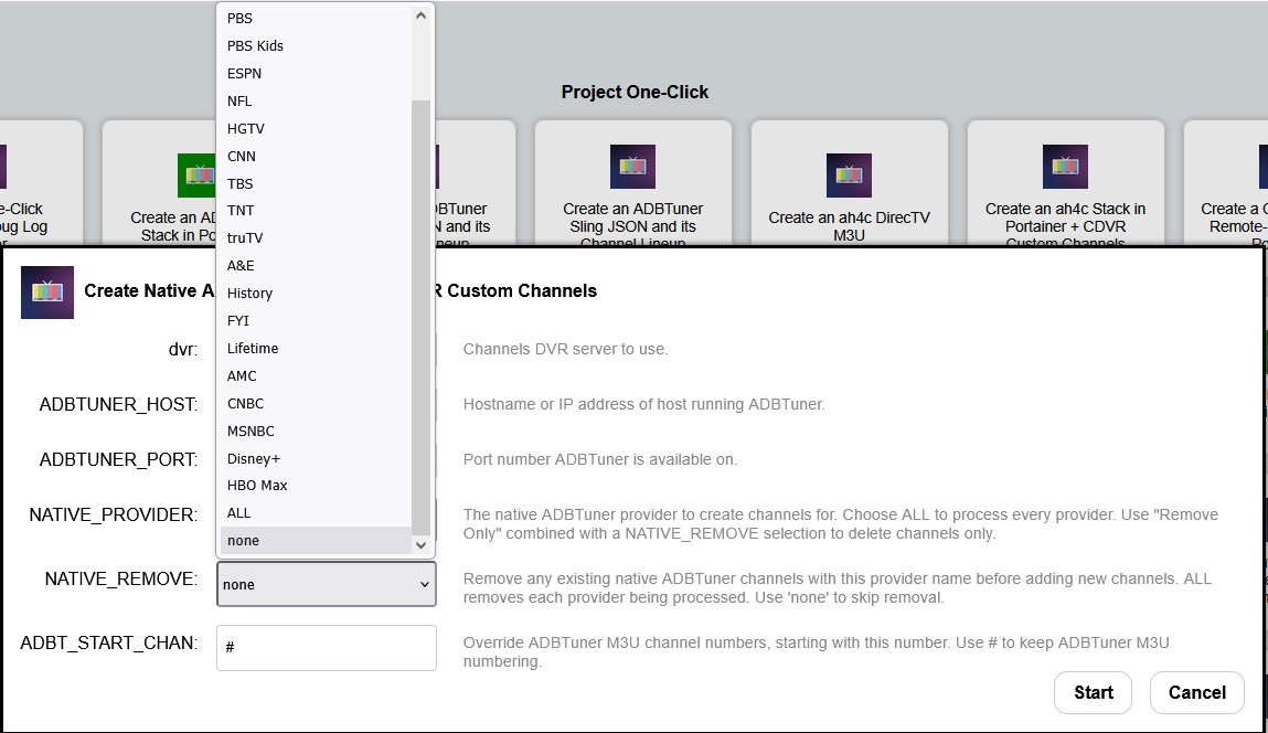

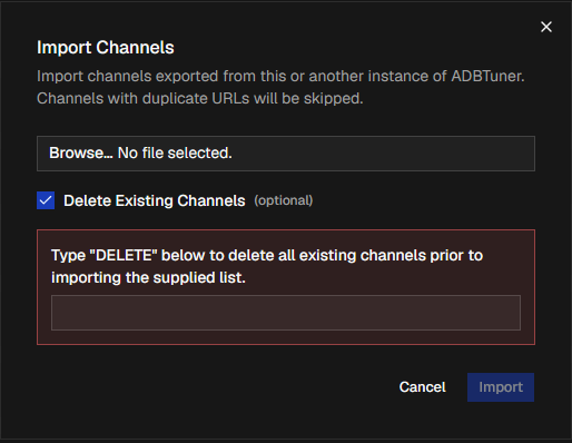

If I import the PBS channel list json, using the "Delete" option, will it only delete existing channels from the same input source? (PBS app) I'd hate to have it dump everything I have worked so hard to set up already.
Are you talking about ABDTuner's "Delete" option?
If so, it will delete ALL existing stations, so don't do that!
Or are you talking about OliveTin's "NATIVE_REMOVE" option?
That one only deletes the stations associated with that source app, so is more like a scalpel.
In either case, I'm not sure why you are looking to delete at all? If you loaded up CBS and now you want PBS, it is just an additive function. They don't overlap in any of the settings, so you can just import them in individually without any worries.

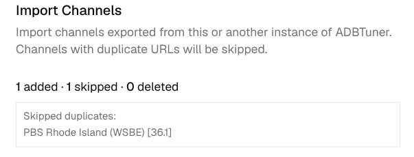

My question was triggered by this issue which occurred while importing the PBS json. It skips the main PBS Local channel, identifying it as a duplicate. No such channel currently exists in my ADBT lineup.
Screenshot 2026-07-27 5.17.49 PM
I thought that it might be leftover Data from a previous attempt to add PBS. I had hoped to use "Delete" to remove the offending duplicate. Good thing I didn't do that. I'm glad to know of the "Native Remove" Olivetin function. Somehow, I never heard of that action.
Do you have any idea why I received the "skipped duplicate" message, and how I can successfully import both PBS channels in your PBS json?
There's a bug in ADBTuner that @turtletank needs to fix. I previously alerted him:
This is exactly what is happening with PBS. Only the second channel "NHK World" is loaded.
I must have missed this conversation. So much has been changing lately, that it's hard for my aging mind to keep up... my :brain: = :poop: :laughing:
I just pushed a new development build (20260728-1). One change, package name and alternate package name are now considered when determining if a "url" is a duplicate.
This should fix those channel list imports with duplicate values in the URL field.
