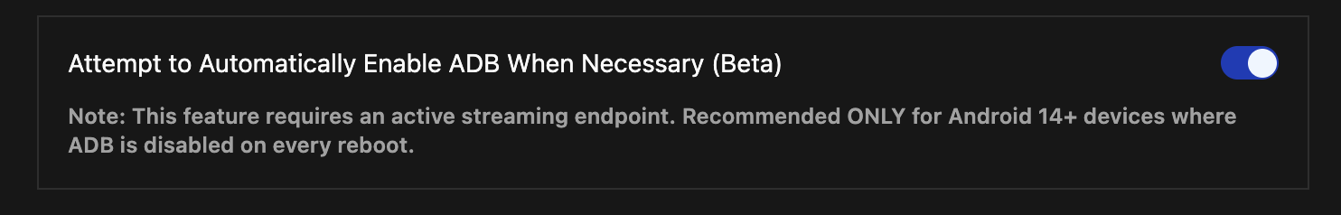

I pushed a new :development build today (20260903-1). It adds a new tuner feature that attempts to automatically enable ADB on connected devices by using remote commands and OCR. The purpose of this feature is to add back some support for the ~3 Google branded devices that reset ADB settings on every reboot.
This is a pretty slow process, it sometimes fails a couple of times because the device might be sluggish after booting up, but it will retry until it gets it right. Expect the device to be back online 2-3 minutes after a reboot. I still recommend using devices that don't have this issue and not rebooting unless necessary, but at least it can recover now.
On a side note, I went through all of the steps to make it possible to just use Wireless Debugging instead of switching the device back to adb over tcpip thinking it would help hedge against future restrictions, but bailed on the idea because the entire wireless debugging stack resets on every Wifi disconnect (such as those caused by routers doing band steering and such). It's just going to be too fragile.

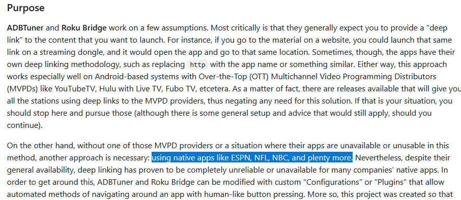

Have you tried this project?
Using the latest build with this feature and my Google Chromecast HD (Android 14) is back online with ADBTuner. I was guilty of trying to intervene with remote keypresses until I realized the recovery was still ongoing. Once I stopped trying to "fix it" and just observed the process, things worked as designed.

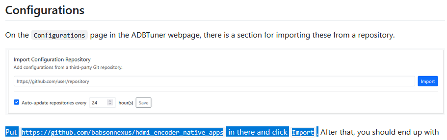

@babsonnexus, Okay, I'm a dork...sorry for missing that and thanks for pointing it out. I've read through the HDMI Encoder apps wiki, but it never specifically indicated the library path to use for the import... so it didn't register that it was the same GIT repository. I put in the repository path //github.com/babsonnexus/hdmi-encoder-native-apps and it worked/imported.
Aren't the various configurations dependent upon the specific app (i.e. Spectrum) and the platform on which they run (i.e. Firestick)? If so, don't the configuration need to be specific for each environment. I guess I'm trying to get my head around how these station specific apps actually work with varying apps and hardware... how does that work?

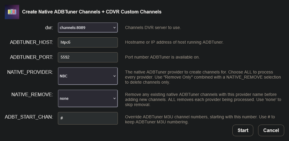

If you don't already have OliveTin-for-Channels installed, you may want to install it, as there's a Project One-Click Action that takes care of everything for you related to setting up HDMI Encoder Native Apps virtual channels for a given streaming stick app. There's also an option to add ALL supported channels in one shot.
The Action adds the virtual channels to ADBTuner, configured to support both generic Android and FireOS devices. It also adds the appropriate Custom Channels Source to your Channels DVR. In addition, it supports a remove function, that can be used as a straight remove -- or if updating, it'll remove previous virtual channels for a given app before adding the updated set of channels.

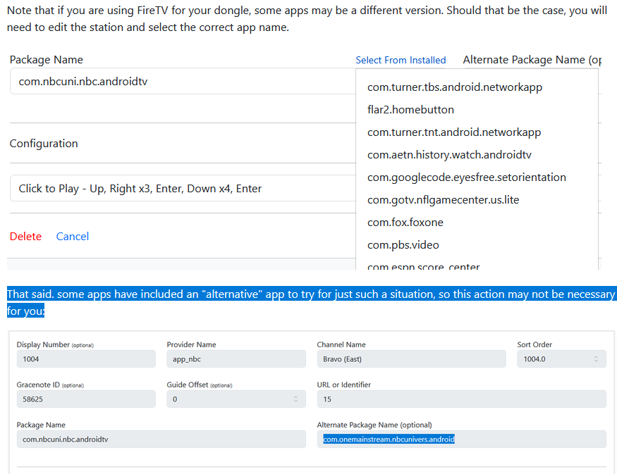

To be very clear, there isn't a Spectrum or any other Cable/Satellite/OTT provider setup in this solution; they would require their own repositories, or at the very least station list. Assuming it would just be one configuration with that special station list, something like with DirecTV and Sling.
I'm not adverse to building one, but there's not a good way (yet) to use the field in that way. I could do it in Roku Bridge right now since that uses basic Python for Plugins, but not in ADBTuner. @turtletank, I guess, then, the request is for the ability to use the URL or Identifier field with a function that would parse it into individual keypresses and pass them on. Just something to keep in mind as you're cooking!
I always try to make it so you don't have to repeat this info again and again!
