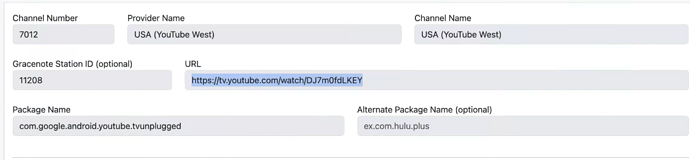

This is what I have for YouTube TV USA West, https://tv.youtube.com/watch/DJ7m0fdLKEY
I am not sure if they are the same for everyone or specific to each login.
how are you finding that information? youtube.tv or looking at adb software?
I found the links through the youtube tv website. And I posted a full .json file for importing into ADBTuner. However, it only contains east coast streams and doesn't contain locals as they are geolocated.
Its not user specific.
I looked in the webbrowser to get it and put it in my ADBTuner.

When I type in this URL https://tv.youtube.com/watch/M2YyNsA47Lw it tries to show me Law and Order:SVU. Maybe your links are wrong.

@dubx99 Here is my YTTV ADBTuner export for west coast.
