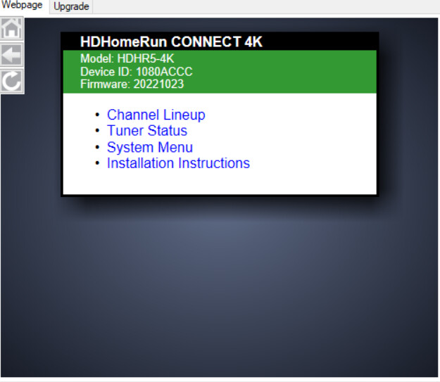

I don't think the firmware you are using has been released. Any way Silicon Dust's HDHomerun app works perfectly with ATSC3.0 on all my various devices. If Silicon Dust releases new firmware that fixes the problems with Channels that will be great.
Well as you know ATSC 3.0 is still in Beta in Silicondust so if you do not want to install the beta Firmware then you cannot blame Channels DVR.
It is released I always use the Windows Setup ....
Download - 20221205 - Silicondust

If you want to keep up with ATSC 3.0 updates, you need to keep up with the SiliconDust firmware Changes .. If you are not up to date on firmware changes you cannot really blame Channels DVR for problems with ATSC 3.0 tuning. If you are scared to update firmware, then do not use ATSC 3.0.

yes that makes sense, but the link you provided for the latest release appears to be for their app and don't think that's a firmware update.
