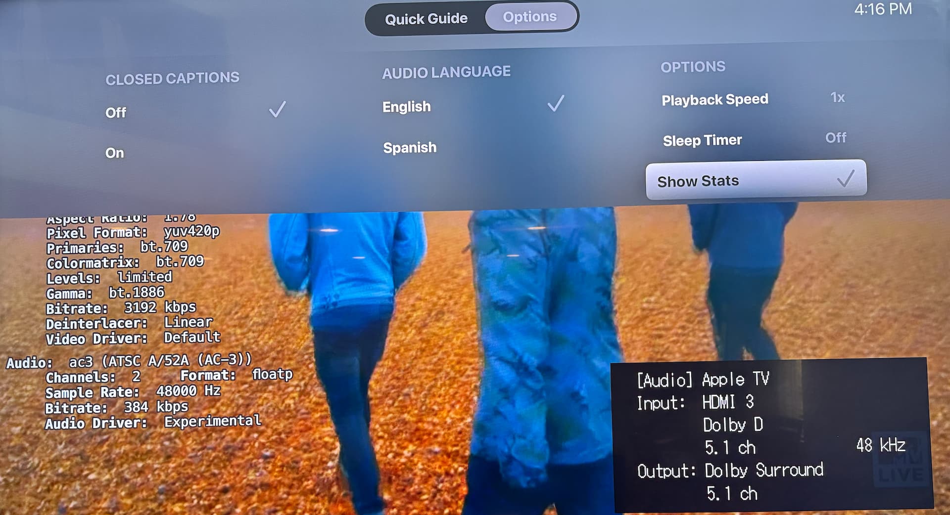

This is tvOS 16.0 (20J373) and running on Channels DVR Version 5.7.5 and it still stuck at 5.1 DD with 2 channels source when the system audio format is set to use 5.1 DD.
Interesting, so maybe this has existed in TVOS 16 as well. I guess the only option for people with Dolby Digital only home theater setups is to run non Apple TV hardware which is disappointing since I think Apple TV runs Channels the best out of any other HW. The audio experience though just isn't worth it. Just noticed you are running experimental driver. Do you see the same with default driver?
