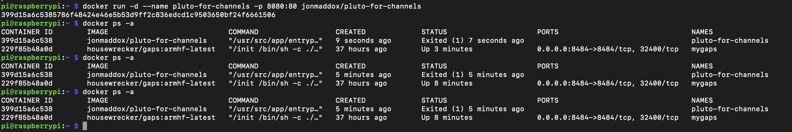

I still can't get it to run on Pi. Removed it from Docker, did another pull and ran the run command but it still exits.
I have it running just fine in my Mac Docker, but do want to move it to my Pi eventually.
Same here with running on pi4. I even tried building the container myself on the pi and it fails with the same "exec format error" as when trying to run the pre-build container. I'm fairly convinced there's a problem with the docker support on the pi.

standard_init_linux.go:211: exec user process caused "exec format error"
The command '/bin/sh -c wget "https://github.com/maddox/PlutoIPTV/archive/$pluto_iptv_sha.zip"' returned a non-zero code: 1
This is the issue as this base image has no arm variants.

OK, the Pluto for Channels docker image is now built successfully for ARM and for Raspberry Pi use. You should be able to fire it up now.

Got it running now. Thanks!

ARM verified here working as well. Great work! This has come a long way in a short time.
