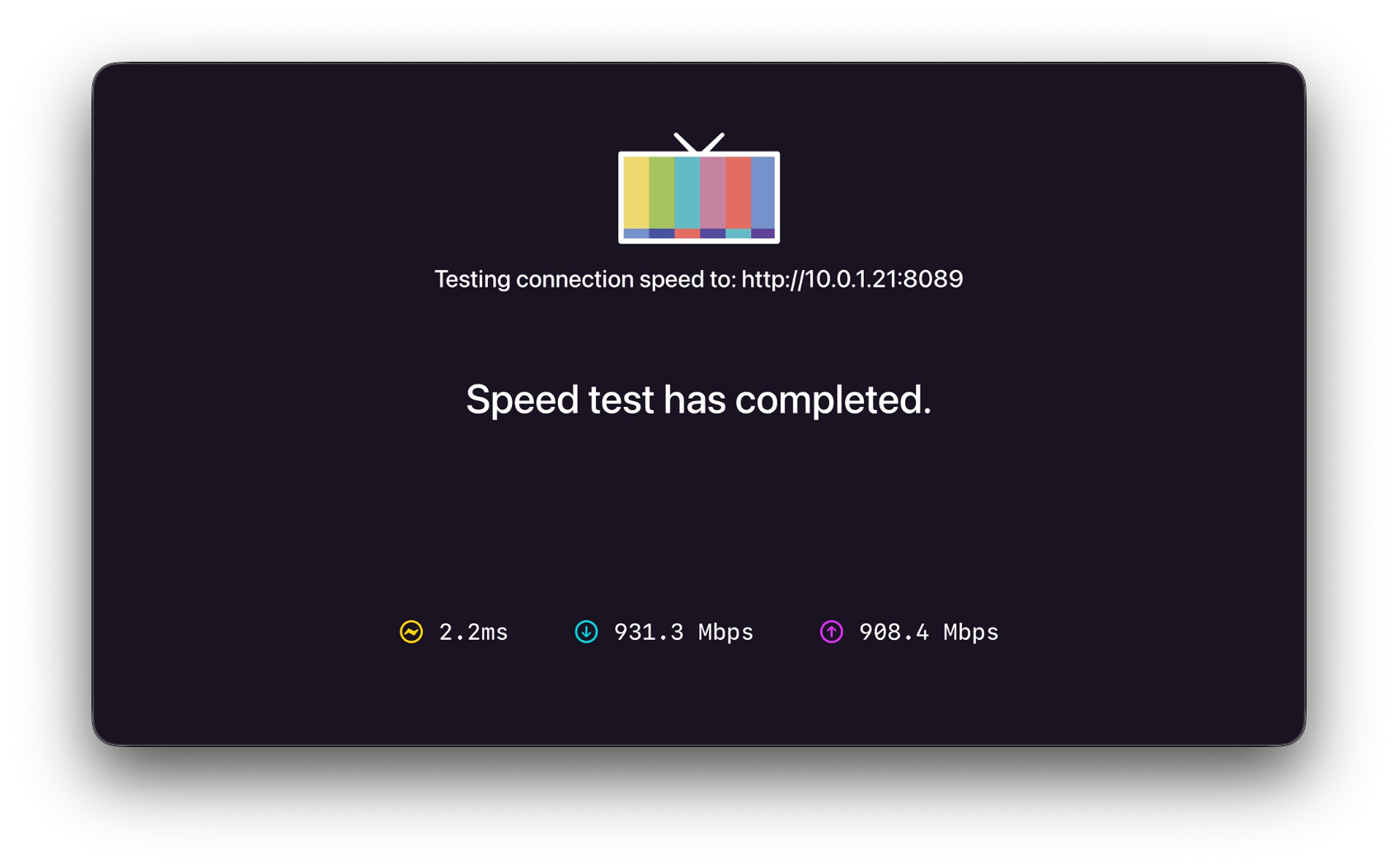

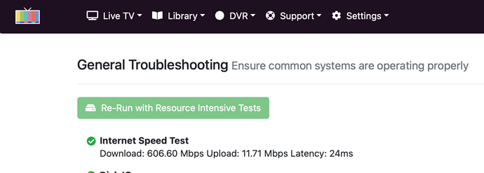

Even though you're connected via Ethernet, it's always possible you're not connecting at full link speed. If you're falling back to 100Mbps, or worse yet 10Mbps that could be the issue. Have you run the CDVR speed test to confirm you have similar performance for the two ATVs?
Good idea but both speedtest similarly:

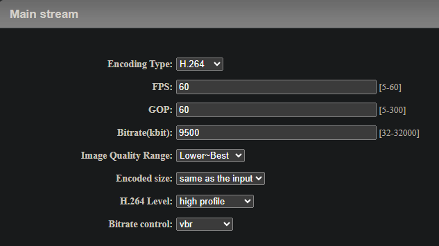

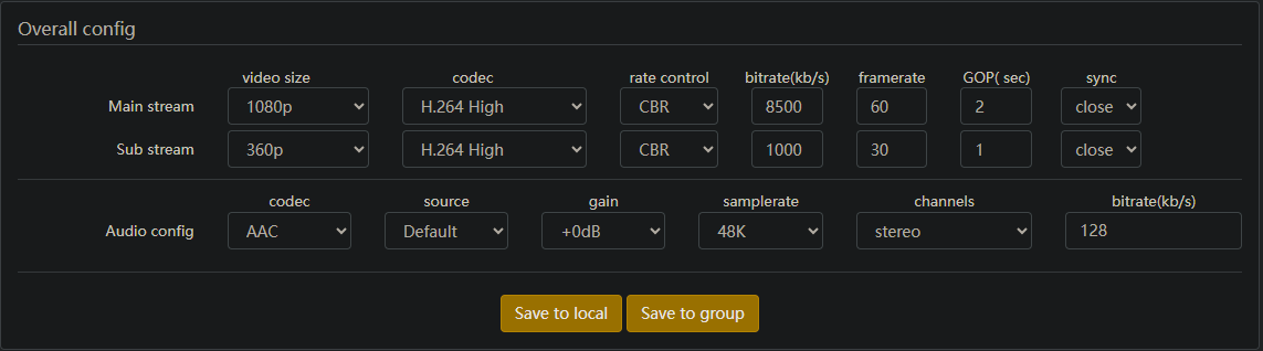

I'm finding with two or more feeds from ah4c or ADBTuner, I can only have a maximum of 3 screens without a very noticeable loss of quality (reduced framerate?).
Encoder settings for ah4c:
Encoder settings for ADBTuner:
screenshot-htpc6-2025-09-20-11-56-53
Input resolution is 1920x1080...
