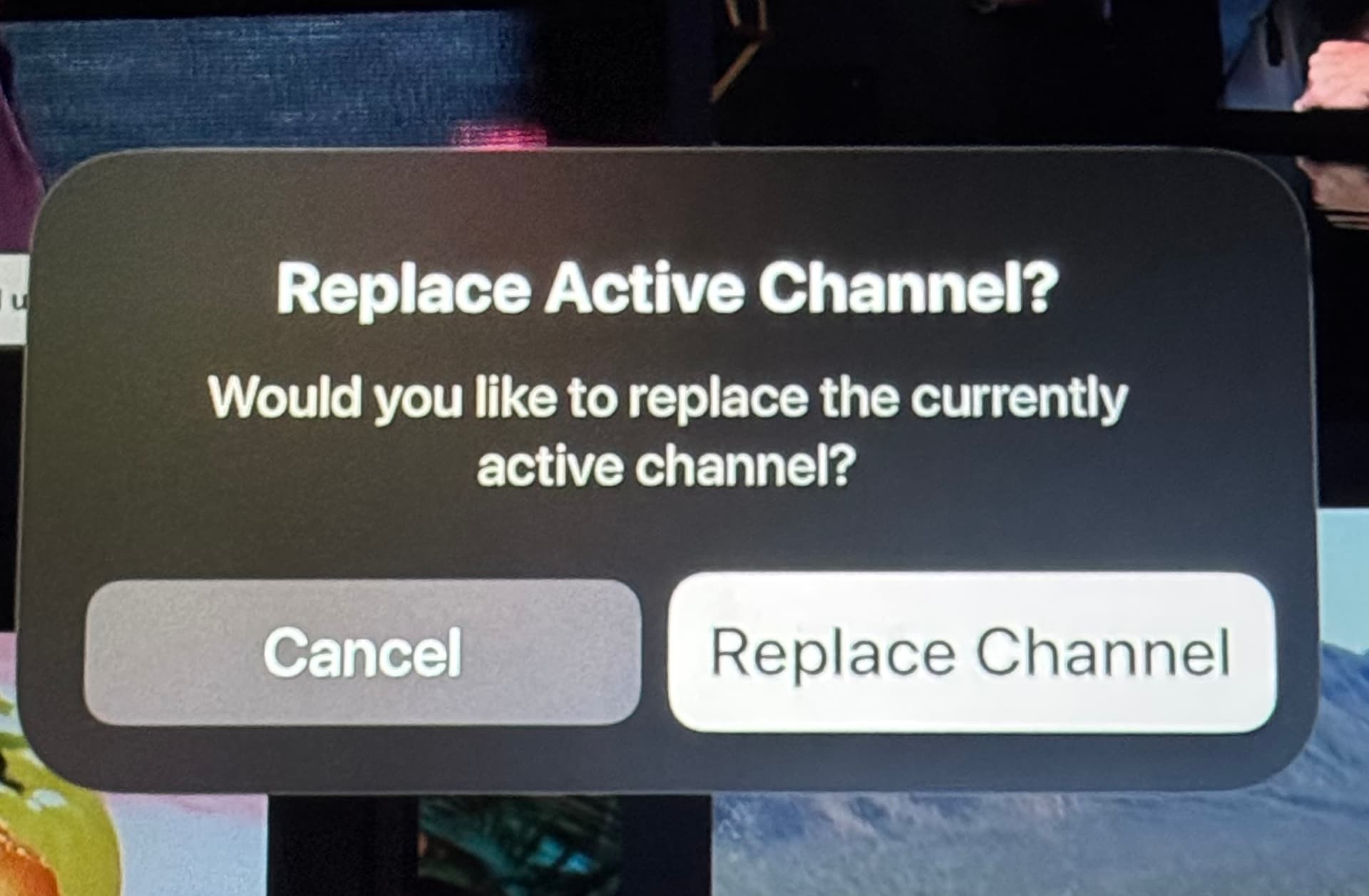

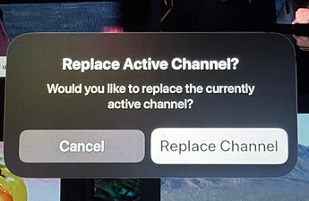

Is there an option to disable the confirmation prompt popup? It should work like the single player Play To.
When I use the Play To option from my phone or Shortcuts, I don’t want to pick up the remote to confirm it. At this point I already made that decision to replace or add the channel.
This was resolved in the latest TestFlight beta:

As of the latest TestFlight beta, you are no longer prompted to replace the active player when a channel is sent remotely:
