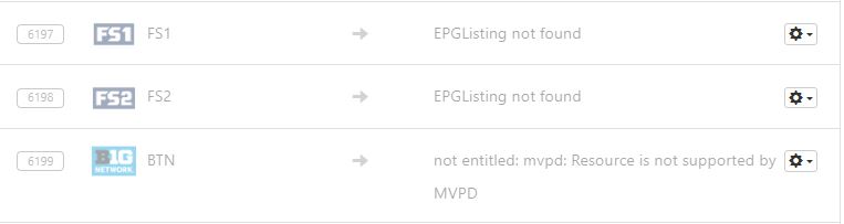

BIG10 & FS1/FS2 - not entitled: mvpd: Resource is not supported by MVPD

2025/07/13 23:23:03.230143 [ERR] Could not start stream for TVE-hotwirecommunications_auth-gateway_net ch6198 FS2: TVE: not entitled: mvpd: Resource is not supported by MVPD
The error that got merged into this thread was 'matching item missing', had nothing to do with this long standing error that OP posted and will continue to exist intermittently.

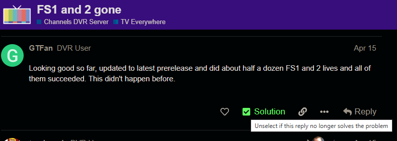

Yep FS1 and 2 gone which you locked and merged to this one. That's really the source of all of this nonsense, the threads should not have all been merged together. Some yes, but not all same issue.

You marked it Solved on April 15th
This thread should really be part of that one because they're the same thing. The latest issue got mishmashed into this.
The MVPD errors do not affect everyone apparently
You might want to unmark your other Topic as Solved if you think it isn't.
So unsolve it, I don't know how. It obviously happened again.
Nvm figured it out
Hi all, OP here. It seems we are talking about a couple of different issues in this thread. My original issue was with FS1/FS2 and the B1G10 network not authorizing and giving some weird error messages.
I tried everything suggested to fix it, but ultimately completely deleting the source and re-adding it fixed the issue. Doing scans, or re re-scanning channels did not.
I just checked, and I can still view these channels now.

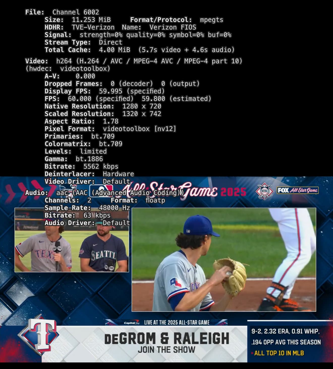

All three channels (BTN, FS1 and FS2) are working with my YTTV Provider on two Channels DVR Servers running CDVR v2025.07.17.0309 (one is Channels :tve docker image, the other is bnhf's :tve docker image).
