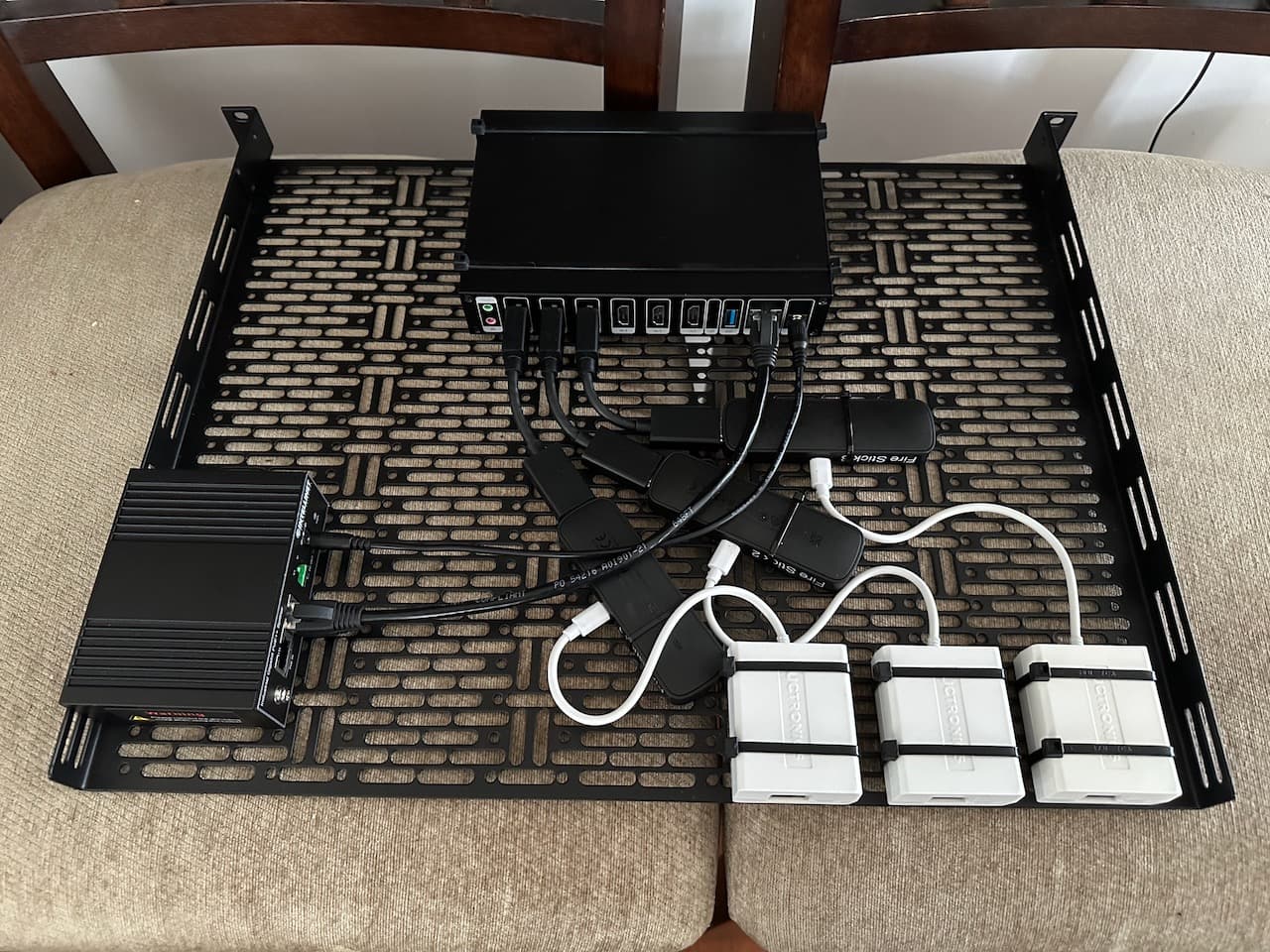

As promised in an earlier post, here's a less expensive (as compared to a PoE-powered rackmount), compact way to build a five tuner LinkPi-based setup.
This uses a well-built seven port USB 3.0 hub for power, some short USB A to right angle micro-B cables (to keep voltage drops low), and some right-angle HDMI adapters.
The streaming sticks are FireStick 4K Max (Gen 2) (currently 20% off with trade-in), as they support Wi-Fi 6, and have a great form factor for a compact build like this.
Due to the proximity of the FireSticks, I would highly recommend the router or AP they're connected to support both 5GHz and Wi-Fi 6 (which has been specifically designed for this kind of high density WiFi, among other things).
EDIT: I've amended my USB hub recommendation. Details can be found here:
I don't love that this is wifi, but I can't not be impressed with what this setup can do, vs the footprint.
:clap::clap::clap:
I feel the same. My rackmount setup will continue to be my daily driver, but this is handy for me for development. I had Multiview running on an iPad for hours-and-hours with all four connections to this little build, and it worked just fine. For those that don't have the space, infrastructure or budget for a PoE-based rackmount build -- I believe this is a workable alternative.
I've had a nearly identical setup, with just three FireStick 4K Max devices running for years in a remote location. In that case, I used a TP-Link smart power strip instead of a USB hub for power. With that power strip, everything can be power-cycled individually (remotely using a containerized HA). The sticks are installed in every other port on the LinkPi in that installation, for whatever benefit that may give the WiFi connections.
